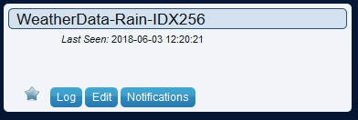

Afternoon!
I followed this page: https://www.domoticz.com/wiki/Virtual_w ... 29_Devices for creating a virtual device for the rain in mm that I get from Weather Underground. The page says "Mission completed, the virtual temperature sensor can now be used in events."

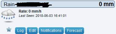

I do have a value for the rain:

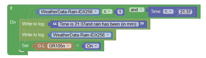

but now I see in Blocky, this is not working yet :( .
Anybody has a solution for this? What I want to do is start my GR105 (*) device or not, on set times like the evening, depending if there was rain in the last 12 hours or not.
(*) https://www.domotique-store.fr/2416-thi ... e-tour.jpg

gizmocuz wrote: Sunday 03 June 2018 12:28 Blockly works with temperature devices, not sure about rain or wind, it should not be that difficult to add, but time is my problem
Yes, when I remove my rain device (IDX256) and replace it with a temperature device, there's no warning of NOT WORKING YET.
Ok, I understand you're the maintainer / programmer of this part of Blocky in Domoticz?
If you can implement this in Blocky, yes please! In a simplified form, this is what I do with Lua:
local idxr = 256
if devicechanged[sensorwu] then
        sWeatherFirst, sWeatherRain = otherdevices_svalues[sensorwu]:match("([^;]+);([^;]+)")
        sWeatherRain = tonumber(sWeatherRain)
        print('sWeatherRain is now' .. sWeatherRain)
        commandArray['UpdateDevice']=idxr .. '|0|' .. sWeatherRain      -- for updating Dummy devices e.g. '96|0|Hello World'
return commandArray
and this works: I see the correct value of IDX # 256 when I go to Setup, Events, Show current values. And this is Devices:
What is not working, is this (IDX256) item in Weather
but I don't mind that. I want to use it in Blocky please.

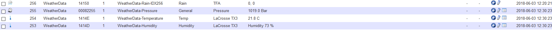

That is probably because you use the wrong amount of parameters for the device
See the Wiki/JSON what values a rain sensor should have (https://www.domoticz.com/wiki/Domoticz_API/JSON_URL%27s)
But again, if you just add the normal WU hardware (no script what so every), and i could make it (not today i think) that in blockly you can use
if (myrain>10mm) then....
Then you could work with this ?
Since you are 'programming' in lua, you might want to have a look in the javascript/cpp code if you want it implemented fast

I installed the update ( Compile Date: 2018-06-04 08:19:42 Version: 3.9571) and indeed, the "NOT WORKING YET" is removed. Unfortunately, my Blocky is not working yet. Can you please have look, whats going wrong?
The script:
and the value:
and the syslog output:
Jun  4 21:47:00 domoticz: EventSystem: Lua script error (Blockly), Name: sprinkler_1 => [string "result = 0; weekday = os.date('*t')['wday']; ..."]:1: attempt to compare nil with number
packetloss
Posts: 48
Joined: Monday 03 August 2015 20:27
Domoticz version: 4.11590
Location: Belgium
Re: Virtual sensor for rain
Post by packetloss »

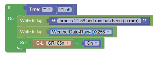

O and by the way, this one is working;
So I conclude that the problem is with the WeatherData-Rain-IDX256 <= 1 item.

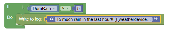

@simania, the 'compare' value for the rain sensor is the amount of rain for the last hour already

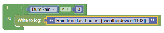

@both, i would say, start simple, make a blockly that just 'prints' the value.
For example, create a dummy rain sensor, and a blockly like:
On the 'devices' page you see the index value of the rain sensor (idx) like 1103.
Rain1
Rain1
note that in the log message, weatherdevice[1103] = rain_rate and when you use raindevice[1103] it is total_rain of today
When you now update the virtual rain sensor with
http://127.0.0.1:8080/json.htm?type=command&param=udevice&idx=1103&nvalue=0&svalue=2;1000
It should print in the log:
2018-06-05 07:26:09.292 Status: Rain from last hour is: 0.02
If we want to do something when there is more then 5mm of rain in the last hour we could make a blockly like:

http://127.0.0.1:8080/json.htm?type=command&param=udevice&idx=1103&nvalue=0&svalue=510;1081
the first part (before the ; is the rain_rate in 0.01mm, 510 = 5.1mm, the last part is the counter (always increasing) in mm
so if the first example (2;1000) was more then 5 minutes ago, you should now have two values in the database (log) after 5 minutes, 1000 and 1081, 1081-1000=81mm of rain today
