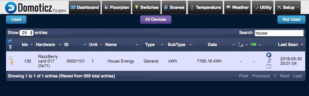

Of course! Thanks.
This my device (idx 130)
Screen Shot 2018-05-30 at 20.01.33.png (105.02 KiB) Viewed 2256 times
and I took your code and replaced the nnn value:
local _ = domoticz.utils._
_.print(domoticz.devices(130)._adapters)
domoticz.log( domoticz.devices(130).deviceType .. "; state: " .. domoticz.devices(130).state)
which gives me a LUA error code: attempt to index field 'utils' (a nil value)
what I'm trying to do is just to push that value (kWh from the house meter) to an external server, something like
local myurl = 'http://www.server.com/savemydata.php?data=' .. ThekWhEnergyfromHouseEnergy
domoticz.openURL(myUrl)
that way I can see the house energy usage without having to have remote access to Domoticz.
