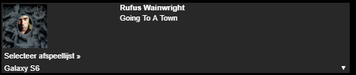

I updated to the lasted beta, but when I add the blok the only thing I see is this, am I missing something?
- dash.PNG (2.01 KiB) Viewed 10565 times
robgeerts
- Posts: 1273
- Joined: Saturday 24 January 2015 22:12
- Domoticz version: 3.7067
Re: Dashticz - Module - Spotify (new version!)
1.) Do you have Spotify open on one of your devices?
2.) If you play something from within Spotify itself, and refreshes Dashticz, doe you get to see an albumcover?

That seemd to do the trick.. although missing the controls, but going to make a new install for this beta.
