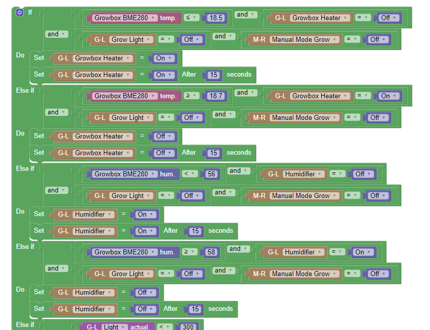

Here is example of my blocky code for the time when the lights are off:
