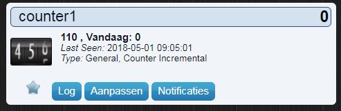

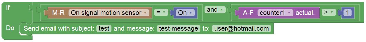

I am new to Domoticz and I cannot get my Blockly with a incremental counter to work, I hope someone can help me out.
I use a motion detector and I want to set a threshold before an email message is send, therefore I want to use a counter that counts the number of times the motion detector is activated. I have created a dummy counter and the Lua event used for updating the counter is set as “Device”.
However I keep receiving the error: "
EventSystem: Lua script error (Blockly), Name: testing counter read_1 => [string "result = 0; weekday = os.date('*t')['wday']; ..."]:1: attempt to index global 'utilitydevice' (a nil value)"
Here is my Blockly, Hardware set up and the Lua code I use to update the counter:
counter log.jpg (15.06 KiB) Viewed 1589 times
counter log.jpg (15.06 KiB) Viewed 1593 times
