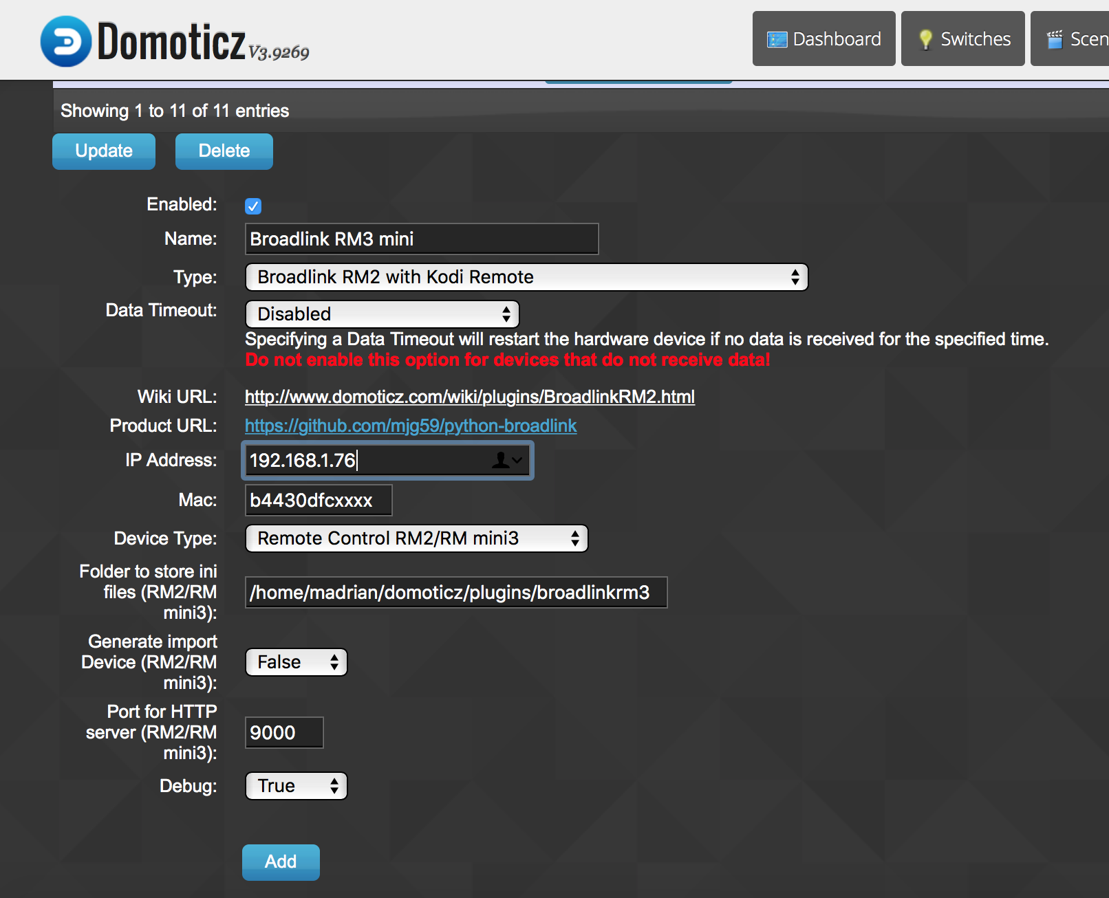

Re: Python Plugin : Broadlink RM2 V4
Hmm, it's already turned on.
Log after restarting domoticz:
And no "Learn" device was created.

What you can do: try to create another HW but first be sure that in Domoticz the accept new hardware/devices settings has been checked.madrian wrote: Saturday 21 April 2018 21:54 Hmm, it's already turned on.
And no "Learn" device was created.![]()
