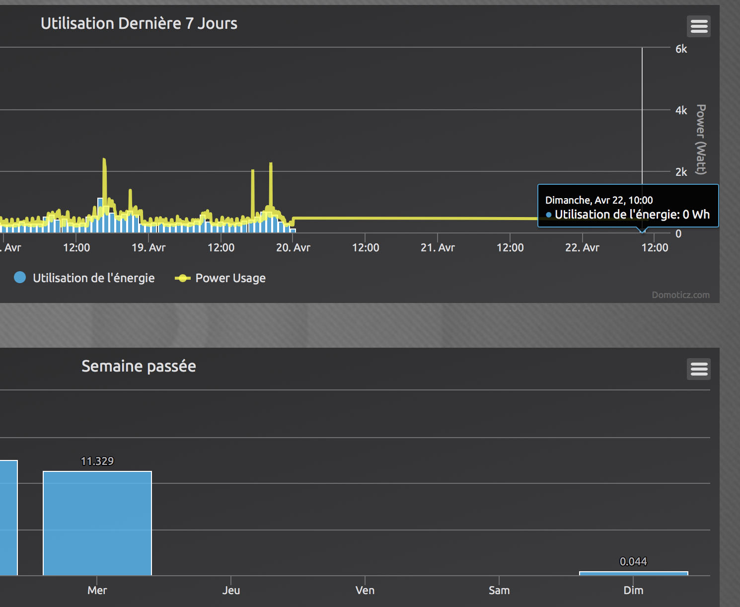

I reset a OWL Micro+180 because it didn't send anymore data to domoticz.
So, I have to restore the backup of the database, add the new device, and replace with the old one to have the entire history of the device.
But I have a problem. One data ("Utilisation de l'énergie") in the 7 days graph is stuck at zero and I don't know why.
If I look in the database, the new values are below than the older one. I think the problem comes here.
But if I change theses values, the problem will occurs again.
Have you an idea please ?
Thanks a lot.

- Capture d’écran 2018-04-22 à 10.46.33 copie.jpg (165.46 KiB) Viewed 1741 times

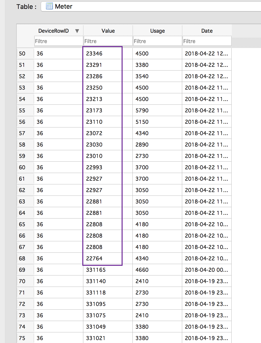

- Capture d’écran 2018-04-22 à 16.16.47.png (290.03 KiB) Viewed 1742 times

Recent data for this type of data is stored in the Meter table. Older data is summarized and moved to Meter_Calender.Unrender wrote: Sunday 22 April 2018 21:05 ...
So if you want manipulate the values of this device in the database you have to do that in both tables.

I tried but it makes wrong data -> consumption of more than 300.000 kWh for a day
And after doing that, at the next send of data, it show again 0 kWh in the first graph.

- waaren
- Posts: 6028
Re: Replace a device and conserve history
If I look at what the domoticz flow is with a similar sensor-device I use:Unrender wrote: Monday 23 April 2018 18:53 It's an OWL Micro+ CM180 (used with RFLink).
Type General and Subtype kWh.
sensor updates DeviceStatus table (sValue field) with "usage;counter" -- independent of what is already in the database
DeviceStatus.sValue is copied to Meter table counter -> Value and computed usage -> Usage -- every 5 minutes
Meter.Value -> Meter_Calendar.Counter and computed Meter.Usage -> Meter_Calendar.Value -- once a day
So whatever you change in the database will not change what comes from the sensor-device. If you cannot access the memory of the sensor-device and change the counter there you are kind of stuck.
The only possible other work-around I can think of is creating a database trigger that modifies the values coming from the DeviceStatus table to the Meter table. My SQL knowledge is far to rusty to create such a trigger without messing up your data even further but there must be enough database guru's around on this forum...
