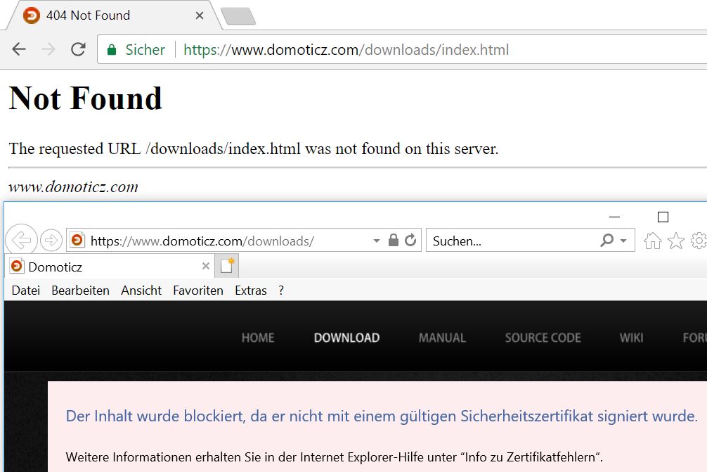

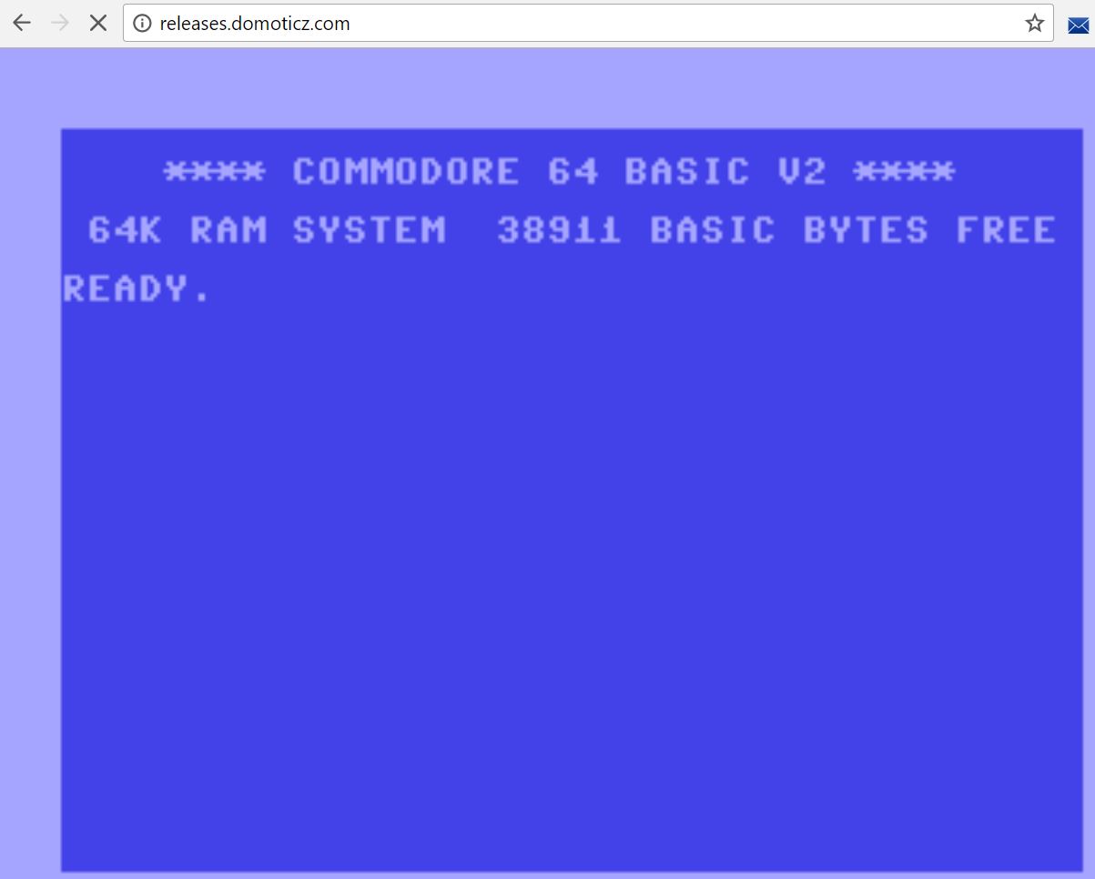

FIT4IT
- Posts: 1
- Joined: Thursday 05 April 2018 6:48
Re: Why is Domoticz impossible to install?
I'm sorry but the download is still not possible (certificate was issued for gandalf.domoticz.com but URL points to releases.domoticz.com/releases/downloads.php) Seems like english is not spoken at https://www.domoticz.com/downloads/index.html
Please find manual download instructions viewtopic.php?f=6&t=22948#p176995
- C64.JPG (52.77 KiB) Viewed 4229 times
- C64 discovered earlier
- Domo Down.JPG (88.52 KiB) Viewed 4229 times
