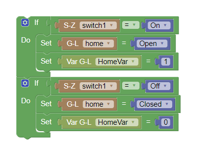

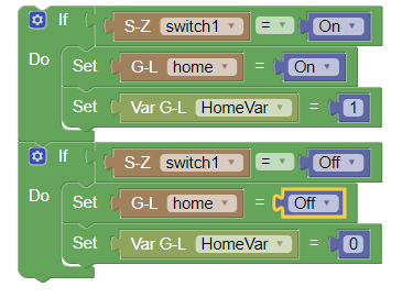

I have now been testing couple precense blockly and lua, with my raspberry domoticz (stable).
It somehow broke up I think after one system upgrade. it was simple as any of 3 phones is online(simple dummy on/off switches) it set fourth switch on and set one variable to 1
I did make it up again but now it wont work. not with simple dummy aswitch or with door contact.
No I even installed clean domoticz (beta) debian vm to my vmware and made it again but now it just wont work. any help?
not even that print line wont work.

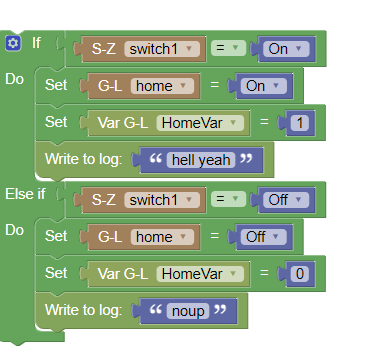

This way it work but I dont want like that :)
I want it like this
if phone1 or phone2 or phone3 is on and anyonehome is off
then set anyonehome on
and other wise
if phone1 and phone2 and phone3
then set anyonehome off
maybe that first check is useless, but somehow I thought it could be good to check..
