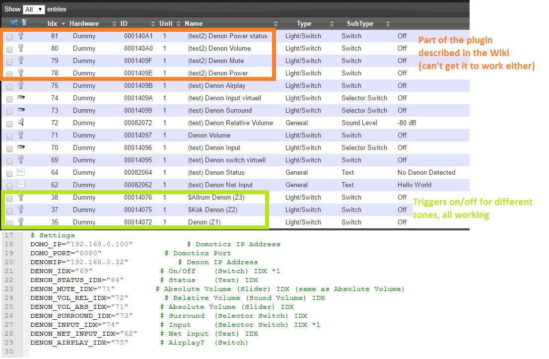

Hi guys,
EDIT: Problem solved, keeping this post for future guidance!
First off I want to thank you for all the hard work you've put into this. I've read the entire thread a few times, both before installing and now again to get help. I'm a beginner in unix and I don't do code so I might have made some rookie mistake, feel free to point and laugh if so. :)
So here's the setup:
*Denon AVR-4200X that I control through HTTP
*Domoticz running on an RPi
When I run the script with the amp turned on it mutes it. I've added the http://IP/MainZone/index.put.asp?cmd0=P ... Mute%2Foff to the On Action and the opposite (On) for the Off Action for the Volume switch according to the instruction.
Here's what I get when I run the script (the not found's are empty lines as someone previously pointed out):

Edit:
Forgot to add the dummy device list and the settings in the script for comparison ->
denon domoticz.png (89.95 KiB) Viewed 164824 times

Firstoff -> Thank you to everybody creating awesome things, and trixwood for denon.sh :)
Maybe somebody can help me out, because i cant seem to find the solution.
i have an RPI, denon avr-x2000, and the denon.sh script in my /home/pi/domoticz/scripts location.
i've configured a few switches:
also configured these settings in denon.sh
# Settings
DOMO_IP="domo" # Domoticz IP Address
DOMO_PORT="80" # Domoticz Port
DENONIP="denon" # Denon IP Address
DENON_IDX="79" # On/Off (Switch) IDX *1
DENON_STATUS_IDX="81" # Status (Text) IDX
DENON_MUTE_IDX="80" # Absolute Volume (Slider) IDX (same as Absolute Volume)
DENON_VOL_REL_IDX="82" # Relative Volume (Sound Volume) IDX
DENON_VOL_ABS_IDX="80" # Absolute Volume (Slider) IDX
but as you can see on the screenshot, i get these outputs on my switches:
202% or 25.0% on my denon.
the denon is using absolute, which i can also see on the webpage from "http://denon/goform/formMainZone_MainZoneXml.xml
<VolumeDisplay>
<value>Absolute</value>
</VolumeDisplay>
and also retrieve "absolute" from using code from denon.sh
"sed -n -e 's/.*\<VolumeDisplay><value>\(.*\)<\/value>.*/\1/p' denon.mainzone.settings"
so i am lost, how can i receive the correct (25.0) output on my virtual device (IDX=80)
