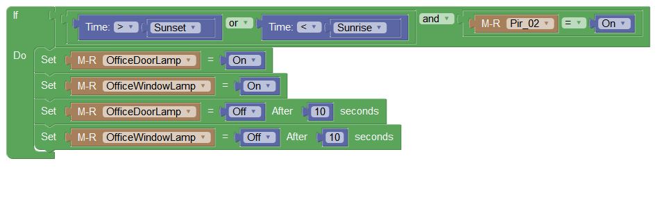

I expect this script to turn light on at sunset and off at sunrise, but it isn't doing either. What did I do wrong?
EDIT: Is it becuase it should be "if time = sunrise" rather than just "if = sunrise"?

You must add "Time"
If time = sunrise
then ....
then don't have to use "after 0 seconds" in the set command

So you have to use the part before the "or" and later on after the "or" :-)

From wiki (turn on dummy dusk sensor)
