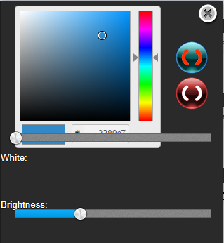

My milight in beta domoticz, has sliders but not in correct place:

Also in default theme? I don't have this (use default theme)tontze wrote: Sunday 11 March 2018 19:07 My milight in beta domoticz, has sliders but not in correct place:

Re: Mi-Light / LimitlessLED / Applamp
Yes. Themes dont bring extra features to devices.
If you are referring to my post, cache clearing doesnt help.
strange. Because i don't have the problem at all:
Are you in latest beta, or stable ?
Latest beta, Updated 2 min ago to 3.9045
i did update too, now it seems to be in its place
EDIT:
Well that didnt last long, now they are off again ..
EDIT:
Here now 3.9047 and have both white and brightness when click RGB logo and there gone when i press edittontze wrote: Wednesday 14 March 2018 19:33 i did update too, now it seems to be in its place
