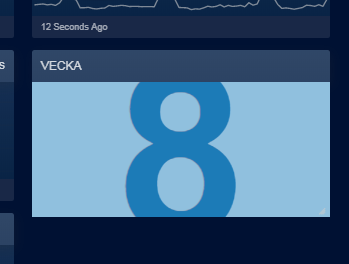

If the value of a text item is a URL, then the theme will automatically turn it into an iframe. This allows you to incorporate external sources into your dashboard, like weather and news feeds.
To try it:
- Create a dummy text item.
- On the Utilities page, click on the text and input a URL.
- Go to the dashboard and enjoy your iFrame.

iframe. where do you enter the url? as the name of the device, description or as the data?

@Xztraz: click on the text. Just try it, you'll find it.

blauwebuis wrote: Saturday 24 February 2018 9:03 @Xztraz: click on the text. Just try it, you'll find it.
i guess its the hello world text? do you have an example of some site that should work in iframe? tried all different fields but only get an icon :D

This works: (adress in data field)
Awesome!

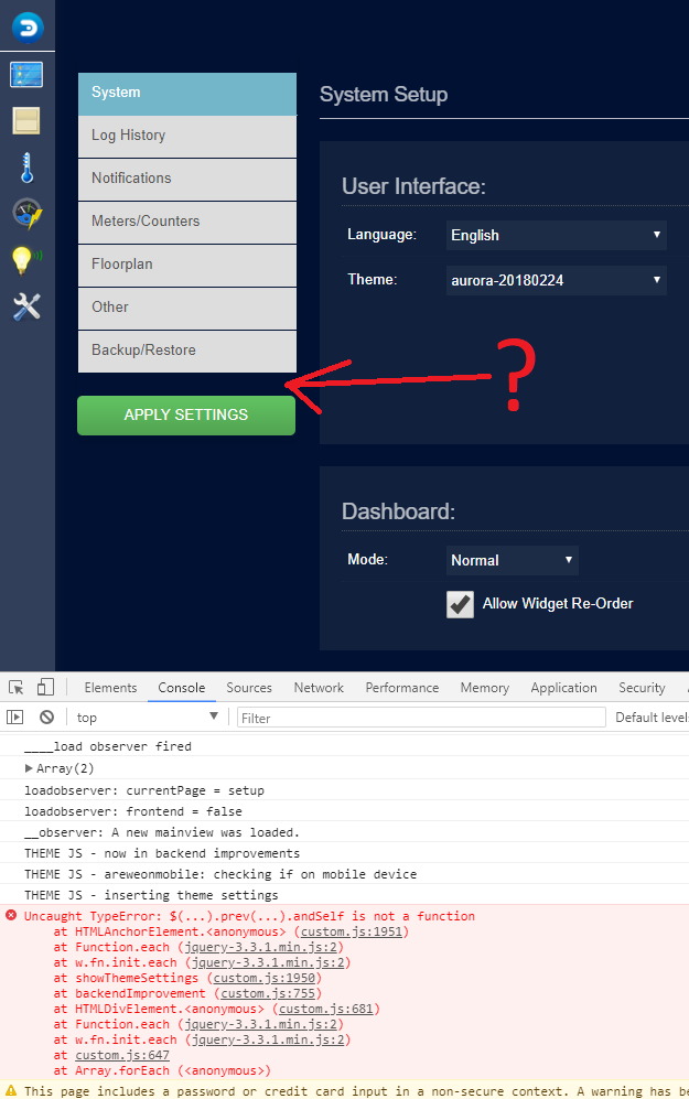

Domoticz Version: 3.8946
I update today to this version beta domoticz, and we lost button "Theme" in settings.
I also check in new version Aurora the same problem.
Of course i clear all cache.
EDIT: becouse jquery in domoticz upgrade to ->jquery-3.3.1.min.js
and from version jquery 3.0 .andSelf() removed, and we have to use .addBack() in line 1951 in custom.js

Post by Xztraz »
tested replacing what you said. seem to work. and made a pull request
