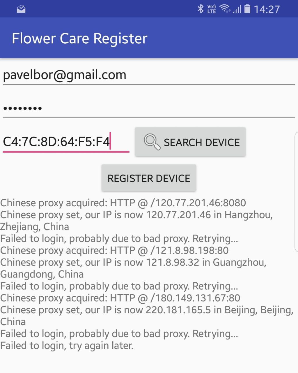

cant login to proxy

pavelbor wrote: Tuesday 27 February 2018 13:29 Hello,
cant login to proxy
That's might be because proxies sometimes are not working correctly. Can you retry a few times, as it will get a random proxy on each trial?
