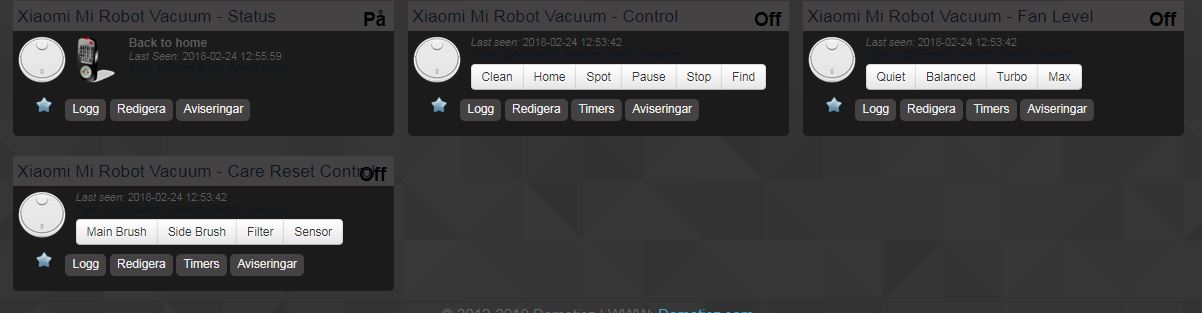

Re: Python plugin: Xiaomi Mi Robot Vacuum
What command's do i use to control the robot?
I want to make script with LUA.
i think i should use:
But what entries? Home , Cleaning or On are not working.
Anysone some ideas?
I did managed to readout the status with:
otherdevices['Robot - Control'] = "".Anysone some ideas?
if otherdevices['Robot - Status'] == "Cleaning" then-
RichardBokker
- Posts: 39
- Joined: Thursday 09 April 2015 20:57
- Domoticz version: 3.9317
Someone, please?RichardBokker wrote: Friday 09 February 2018 17:04 What command's do i use to control the robot?
i think i should use:But what entries? Home , Cleaning or On are not working.Code: Select all
commandarray['Robot - Control'] = "".
Anysone some ideas?
I did managed to readout the status with:Code: Select all
edit:
found, it is: commandArray['Robot - Control''] = 'Set Level 10' (or 20, 30, 40, 50, 60)
The code you pasted for your IF statement seems to only check if its either On or OFF. But not if its Cleaning, Paused, Sleeping, In Error, Charging, Back to home, etc.RichardBokker wrote: Monday 12 February 2018 11:52Someone, please?RichardBokker wrote: Friday 09 February 2018 17:04 What command's do i use to control the robot?
Anysone some ideas?
edit:
After your tip on controlling the robot, I think I might have found the fix to override the Xiaomi Mi Robot Main Brush Blocked fault error and have it continue cleaning.
Here's the Lua script:
if otherdevices_svalues['Robot - Status'] == "In Error" then
print ("Resuming the Cleanup")
commandArray['Robot - Control'] = 'Set Level 10'
print(otherdevices_svalues['Robot - Status'])
return commandArray-
I got the script working, but had to convert the Robot - state with tostring().
Here is my case-construction that i'm using.
-- Using TimeBetween script in main LUA script folder
package.path = package.path .. ';' .. '/home/pi/domoticz/scripts/lua/script_time_TimeBetween.lua'
local TimeBetween = require('timebetween')
time = os.date("*t")
-- Possible state's of Robot Vacuum: Charging / Paused / Cleaning / Waiting / Back to home / Sleeping
-- Selector witch Robot Vacuum: Clean(10) / Home(20) / Spot(30) / Pauze(40) / Stop(50) / Find(60)
---- Variabele to use
-- StoffieState (uservariable)

Hi!
I have installed the plugin, and got the hardware setup. But, my devices are all out of sync and does not really do anything.
Where should I begin my trouble shooting?
I have checked the robots ip and token-settings, they are correct.
EDIT:
I just noticed that the parameters of the switches updates when I run sudo ./miio_server.py 192.168.1.233 476e6b70343055483230644c53707a12 --host 127.0.0.1 --port 22222
The server, however starts on port 59238 and is giving correct data from the vaccum. The port it starts on seems do differ between the server starts.
What is causing this, and what should I do to remain a stable connection.
When the switches updates in the Domoticz interface, I am still unable to send any commands to the vaccum via the switches.
Thank you!

Hi!
EDIT:
Thank you!
