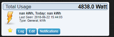

Hello All,
I'm receiving total current load via MySensors and voltage from a Sonoff POW. I then created a dummy sensor as follows
Idx: 46
Sensor Type: Electric (Instant + Counter)
Type: Usage
Energy Read: Computed
The power wattage is calculated in Node-Red and sent to Idx: 46 via MQTT. The payload is as follows.
    "idx": 46,
    "nvalue": 0,
    "svalue": "5191;0.000"
It was working fine from June 6 until a couple of hours ago. Now, the sensor value in Watts is visible but computed Energy usage (Total & Today) show nan.
Any help?

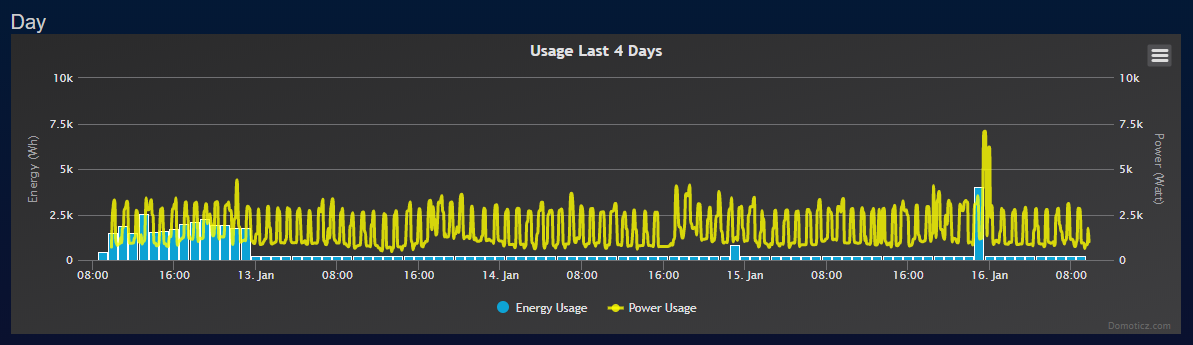

I have the same problem... I'm getting strange data/graphs with both calculated and energy from device. Power seems OK, but energy isn't correct. No warnings from the script, and there should be no reason to have zero energies appearing like this:
Version: 4.10717
2020-01-16 09_51_23-Domoticz.png (88.22 KiB) Viewed 3381 times

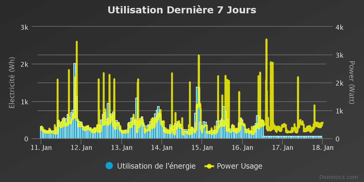

I also have a similar issue :
- MySensor gateway attached through local USB, successfully sending V_WATT & V_KWH every minute, freshly updated as shown here :
- Energy values are set "from device" rather than "computed"
- but yesterday, after a domoticz OTA software update, the energy consumption (Watt.h) histogram has gone flat :
- the DB shows that the both Watt and Watt.h actual values are correctly recorded in the corresponding table:
sqlite> select * from Meter  where DeviceRowID=76 order by date desc limit 10;
DeviceRowID|Value|Usage|Date
76|15236|5911|2020-01-18 00:05:00
76|15184|7033|2020-01-18 00:00:00
76|15134|5618|2020-01-17 23:55:00
76|15087|5570|2020-01-17 23:50:00
76|15040|5356|2020-01-17 23:45:08
76|14992|5379|2020-01-17 23:40:00
76|14946|5323|2020-01-17 23:35:00
76|14902|5445|2020-01-17 23:30:01
76|14859|4503|2020-01-17 23:25:01
76|14815|4499|2020-01-17 23:20:02
- however at the time of the update, it appears the Watt.h value was reset:

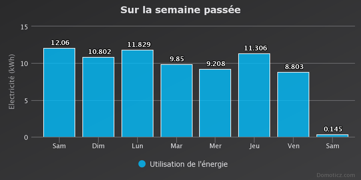

- However the daily sums over a week are correct for today (the sum was wrong on the day of the update and showed 157 kW.h, ie the recorded value before the drop, so I mended manually in the Meter_Calendar table) :
- this has happened once before, after a domoticz reboot if I remember correctly.

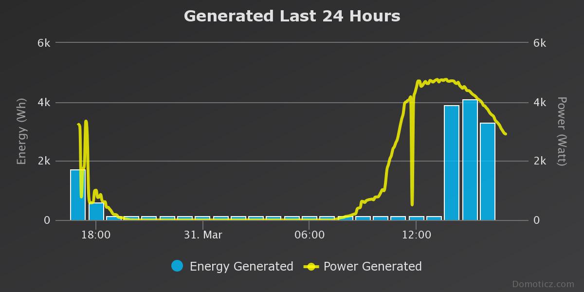

Gruzi
Joined: Friday 28 February 2020 9:06
Re: Electric (instant+counter) - Domoticz doesn't compute Energy
Post by Gruzi »
Did someone manage to solve this issue?
I have something similar.
The values delivered by the solar panels are ok. Values are Power and Energy, part of log:
Date Time - Power - Energy
2020-03-31 10:47:03.774 Status: LUA: data= 2621;2500.0
2020-03-31 10:51:05.608 Status: LUA: data= 2727;2700.0
2020-03-31 10:55:08.822 Status: LUA: data= 2862;2900.0
2020-03-31 10:59:03.334 Status: LUA: data= 2951;3100.0
2020-03-31 11:03:05.096 Status: LUA: data= 3204;3300.0
2020-03-31 11:07:03.690 Status: LUA: data= 3430;3500.0
2020-03-31 11:11:03.834 Status: LUA: data= 3606;3800.0
2020-03-31 11:15:05.495 Status: LUA: data= 3835;4000.0
The graphing of the Power is ok, yellow line.
The graphing of the Energy is 0 until 14.00, blue line.
Why is the Energy graph 0 until 14.00 and from 14.00 displayed?
generated-last-24-hours (1).jpeg (46.86 KiB) Viewed 3036 times
