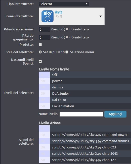

I thin you won't need to create a selector that act a pushbutton that act something else
let's have the selector act streight the action you need....

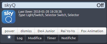

then... you probably want (to simulate a pushbutton) that once pressed the selector will return to off position.
Well, I do have few scenarios like this...
example: SkyQ decoder, my selector uses both commands and shortcuts the configuration of the switch will trigger an action (in my case a bash/python script) and to be able to move back the selector to 0 I use a dzScript
hope this would help
ciao
M
active = true,
on = { devices = {'skyQ'},
execute = function(dz, devVol)
devVol.switchOff().afterSec(2).checkFirst().silent()
}ciao
M
