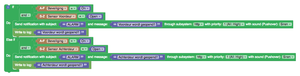

I'm currently in the process of converting my Blockly scripts to dzVents.
I've a Blockly script that sends a notification when the front- or backdoor is opened, while the switch "Beveiliging" has status ON
Sensor - Blockly.png (72.1 KiB) Viewed 1386 times

This works partly, but I cannot figure out what I'm doing wrong (I'm not a programmer and doing this with looking at examples)
In the Domoticz log (and also the notification) I get for both frontdoor (voordeur) as for backdoor (achterdeur) "Beveiliging: De voordeur wordt geopend"

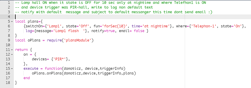

I finish ver 1.1 (tested by friends).
You can download and read about it here viewtopic.php?f=59&t=21914
Simple egzample script.
