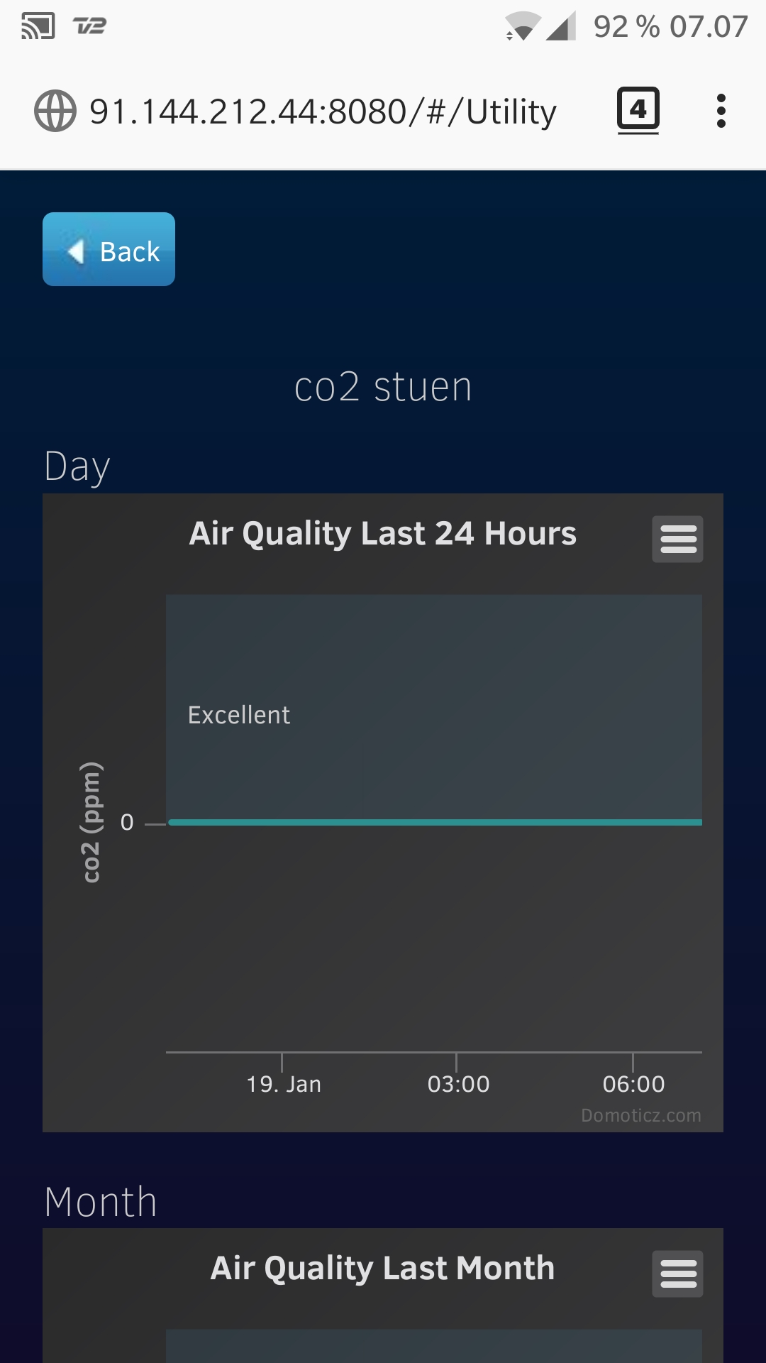

Yeah but nothing happening in domoticz. I can see that the "last seen on, the time" is updated.jvdz wrote: Thursday 18 January 2018 22:29Not sure I understand this. When you update the ESP rules things should work fine and the value in the log should be displayed in the domoticz device.Mads wrote: Thursday 18 January 2018 22:09 //there was a reading in Domoticz, but now it just 0PPM on the dashboard :/ it goes between 0-111.. has I something to do with the calibration?
Jos
But the readings just says 0 PPM
And if i look in the log, nothing has changed the last 24 hour.

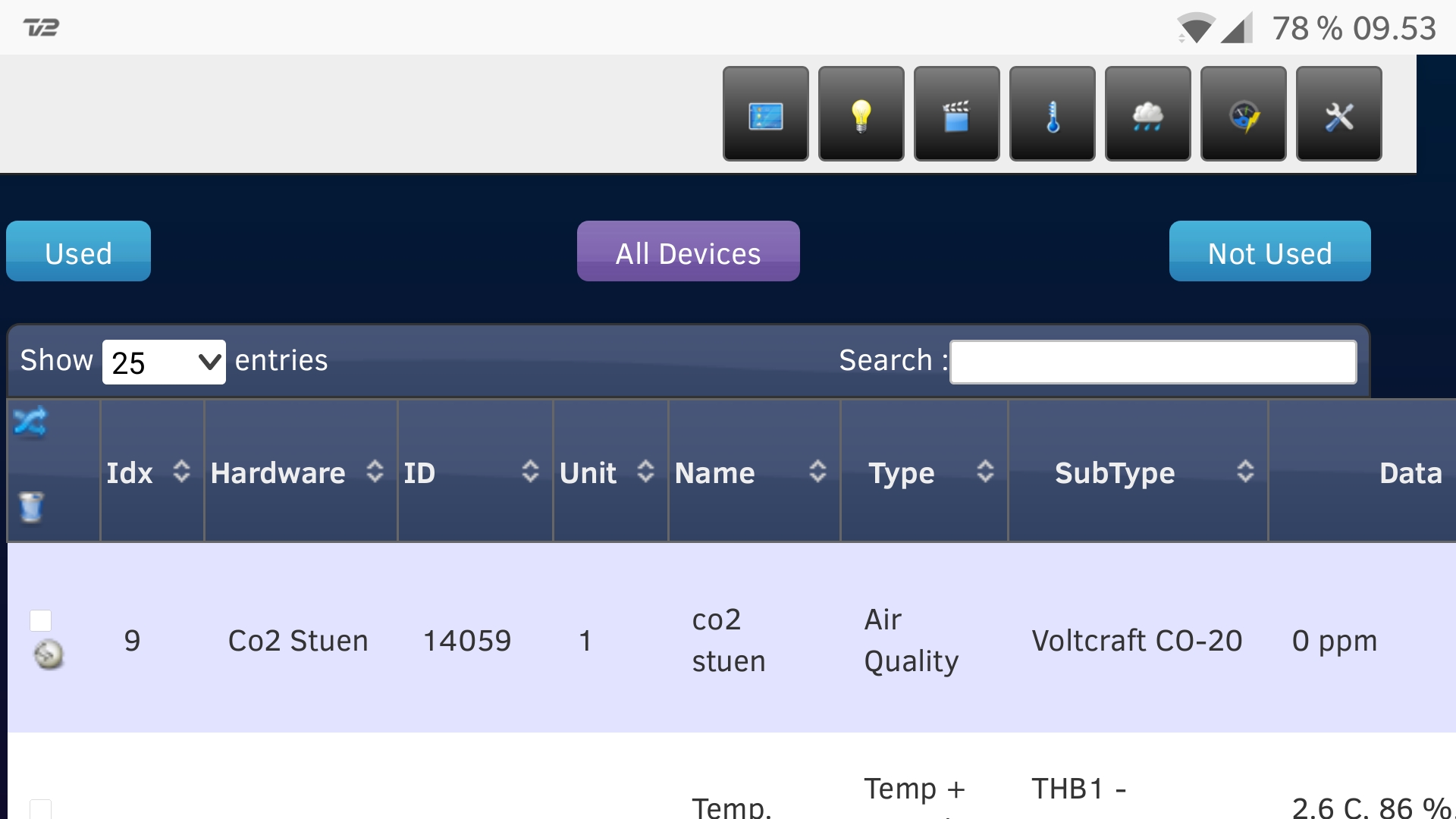

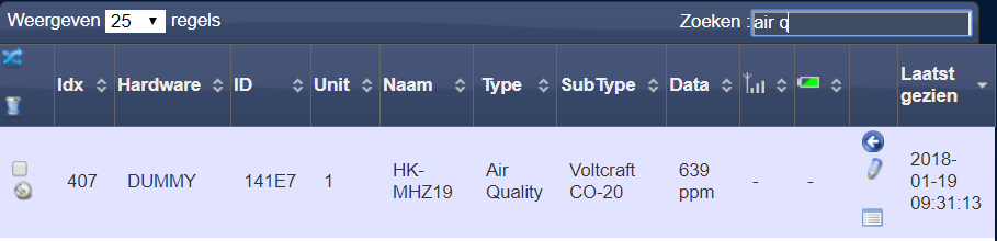

What exactly is shown in the Domoticz Devices page for this device?
It should be something like:
It should already update when you do the manual URL as we discussed.

Mads
- Posts: 40
- Joined: Thursday 18 January 2018 20:57
Re: ESP8266 Air quality sensor
Have this
