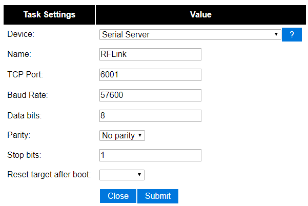

Then I try to set up the "serial server"
serial server.gif (7.78 KiB) Viewed 4059 times
After adding to Domoticz as a RFLink LAN nothings happens, no output from the serial server?
Do I have to set something else, GPIO?
Connect with "telnet 192.168.157 6001" works I can connect but no output?
How can I debug?

Hi @Brommetje, I don’t know from the top of my head, but from memory I can recal that the baudrate should be set to 96000 instead. Exact details where mentioned in this thread on page 2 if I’m not mistaken.
I’ll see if I can make a screenshot ones I’m home

Re: Wifi RFLink
Post by Bladerer »
I just checked and settings seem correct, mine are exactly the same. Did you set the controller IP address, protocol to “Domoticz HTTP” and the port your HTTP server is running on?
Those settings can be found on the “config” tab on the ESPEasy.

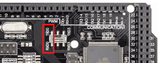

What settings are your dipswitch on? And did you also changed the RX/TX port on the mega. This is one of the other switches on the PCB. I forgot to describe that earlier but I also changed that switch before it started working.

Hi, debugging with telnet is not working I think, but I found the problem.
You have to set it to RXD0/TXD0 otherwise no output.
