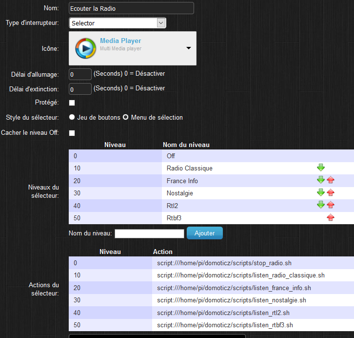

5. Create a virtual selector switch in Domoticz, and create as many levels as you have radios you want to listen.
Assign the scripts created at step 3 to each level, and the "stop" script (step 4) to the "Off" level

Yes, selector switches are terrific.... In a previous version, I had one switch per radio station... Now I have a more compact swith panel.
