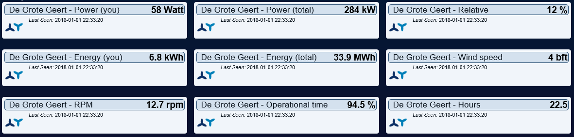

This is my first version of the Windcentrale plugin (similar to the Winddelen device), and still alpha. But already running 48 hours on my RPi.
The standard 'Winddelen' device only displays the current power of the windmill. This plugin gives you more detailed information about the production off the windmill, like current power, energy produced this year, windspeed, rotation speed, etc.
Be careful!!! I am using undocumented support for client side HTTPS.
This is alpha quality only, so please don't use it on your production instance!
Plugin can be found on: https://github.com/Xorfor/Domoticz-Windcentrale-Plugin
