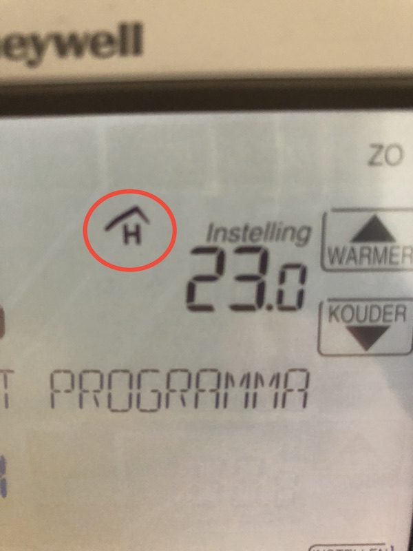

When I set the temperature with domoticz I get a (new) symbol in the display of the thermostat.
Does anyone have a good explanation for this symbol (see picture) ? I could not find it in the manual.

Ok I finally found the time to look into this and my o my ... This was easy...
it works like a charm...
one question though
(explanation: I set the room temperature to 23 and I will see this on the display on the thermostat after 2 minutes.)

Good questionsincze wrote: Thursday 25 January 2018 9:07 2 minutes delay with second domoticz installation or 2 minutes delay with ser2net solution ?
2 minutes delay using ser2net (as in using OTGW LAN)

Ok. I Guess this is the famous Boiler/Thermostat acceptance thing.
You can check it by instead of using ser2net you run the OTMonitor on the client pi and temporarily relay the messages via OTMonitor to Domoticz.
- You set the thermostat in domoticz
- You can see the temperature override in otmonitor & domoticz
- After that it takes some time before the boiller / temperature accepts it and shows it in the top part..
But fun part is with OTMonitor you can see what happens.
It works that is the best thing.

It will show TT20 for example in domoticz log.
You can switch to otmonitor and will see TT20 as the domoticz log gets this from otmonitor.
After a while you will see the requested temperature appear in temp override field.
It seems all is working as requested but for your confidence just check it.
revert back to ser2net afterwards. It will work. Has been working here for several years.
