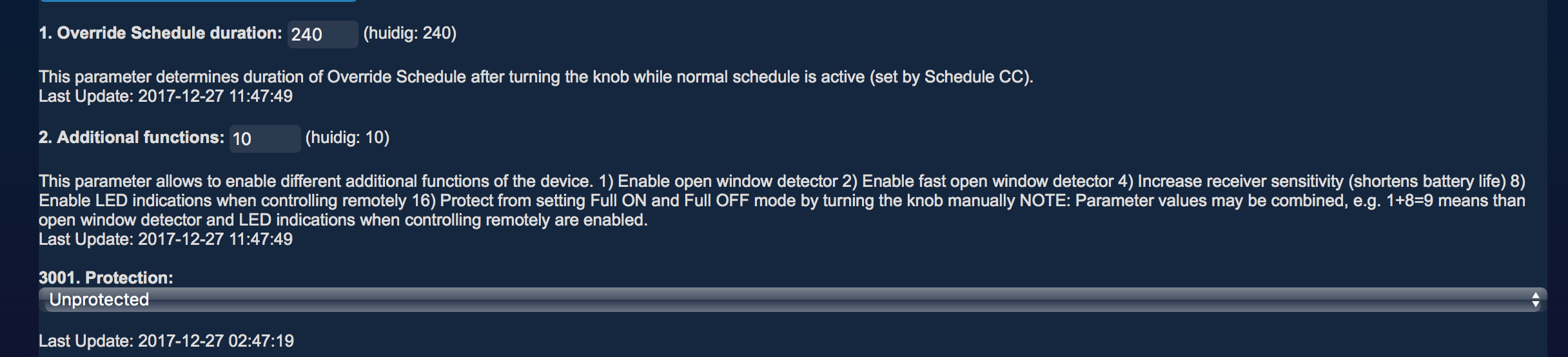

Still the issue of not seeing the read-only tags in '3. Additional functions status (READ-ONLY)'
It does not appear in the config settings at all, even not in read-only mode (as it should)
Available settings:
1 (bit 0) - optional temperature sensor connected and operational
2 (bit 1) - open window detected
Default setting:
0
Parameter size:
4 [bytes]
What could be the cause for this?
Available settings:
Default setting:
0
Parameter size:
4 [bytes]
- Schermafbeelding 2017-12-27 om 20.11.21.png (180.05 KiB) Viewed 3585 times
