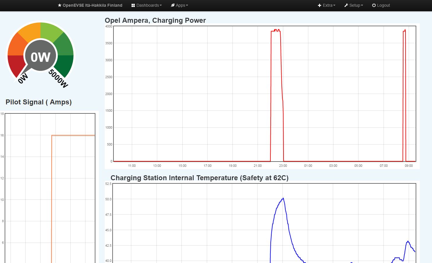

I have now finalized my build of OpenEVSE Kit Build 2 kit and also tested that their Wifi kit works with OpenEnergyMonitor.

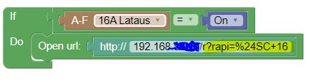

Now OpenEVSE has new firmware to the ESP8266 Huzzah board and I can not send RAPI messages though website.
I tried to send RAPI messages trough Events, but those does not end up to OpenEVSE wifi board.
Same line copied to web browser works perfectly, but not trough Domoticz Blocky events.
Any ideas how to communicate trough Domotocz with OpenEVSE board, I mean guide for dummies :)?
