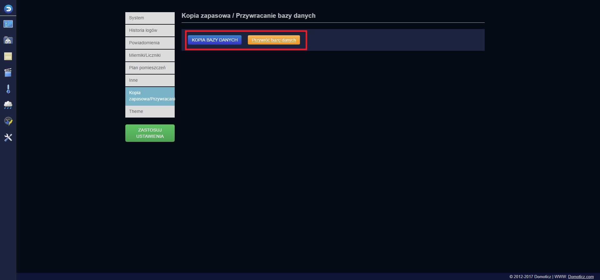

And when i copy directory aurora to /www/style this theme not working. I must under directory aurora\aurora4-mobile copy file to to directory aurora and theme start working
In backup page button do backup and restore has other style:

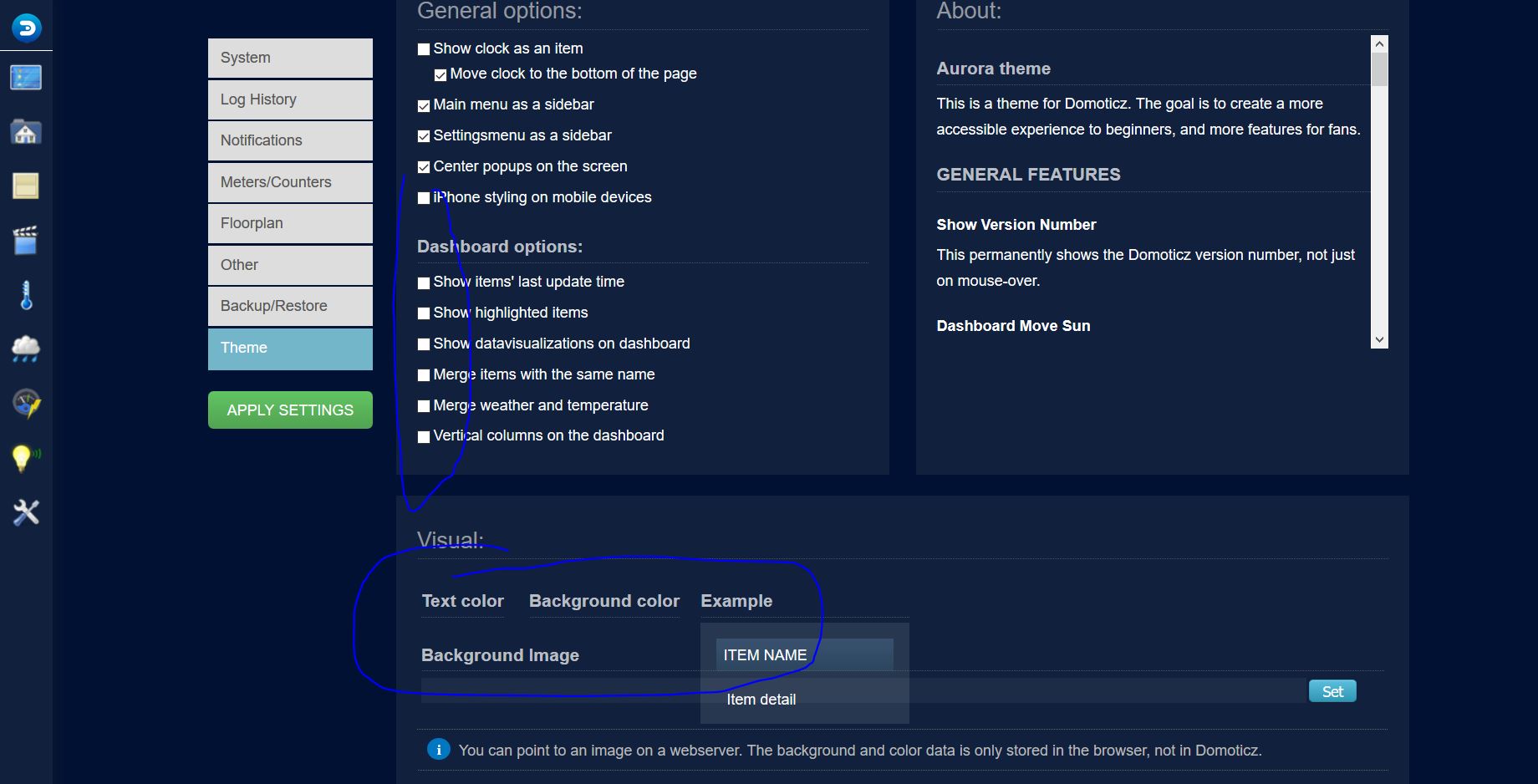

madpatrick wrote: Monday 18 December 2017 6:11 I'm having the same issue.
Tried to clear cache on several ways, restarted the server,....
I see no errors in Chrome
gijsje wrote: Sunday 17 December 2017 22:17 I have the issue that it does not show corect but i have it with all the themes.
I did delete the cache and did try ctrl F5
Any ideas?
Same problem here!! In Safari, Chrome and FireFox....

gijsje wrote: Monday 18 December 2017 15:46 If i edit the custom.css and add this it works a bit better but still not as it should be i think.
/* These are the minimal required CSS files for the theme. The rest is loaded via javascript. */
@import url("aurora.css");  /* Don't remove this line! */
@import url("base.css"); /* Don't remove this line! */
@import url("center_popups.css");  /* Don't remove this line! */
@import url("dashboard_camera_previews.css");  /* Don't remove this line! */
@import url("dashboard_highlighted.css");  /* Don't remove this line! */
@import url("dashboard_highlights_see-through.css");  /* Don't remove this line! */
@import url("dashboard_merge_items_with_same_name.css");  /* Don't remove this line! */
@import url("dashboard_move_sun.css");  /* Don't remove this line! */
@import url("dashboard_show_data_visualizations.css");  /* Don't remove this line! */
@import url("dashboard_show_last_update.css");  /* Don't remove this line! */
@import url("dashboard_vertical_columns.css");  /* Don't remove this line! */
@import url("extras_and_animations.css");  /* Don't remove this line! */
@import url("navigation_main_sidebar.css");  /* Don't remove this line! */
@import url("navigation_settings_fixed_tabs.css");  /* Don't remove this line! */
@import url("navigation_settings_sidemenu.css");  /* Don't remove this line! */
@import url("oldbrowser.css");  /* Don't remove this line! */
@import url("show_version_number.css");  /* Don't remove this line! */
Looking more like it should, but still alot is missing

@piokuc thank you for your help!
- I've made it so that long words are not broken into multiple lines.
- I could style the buttons for backup and restore. hmm.
