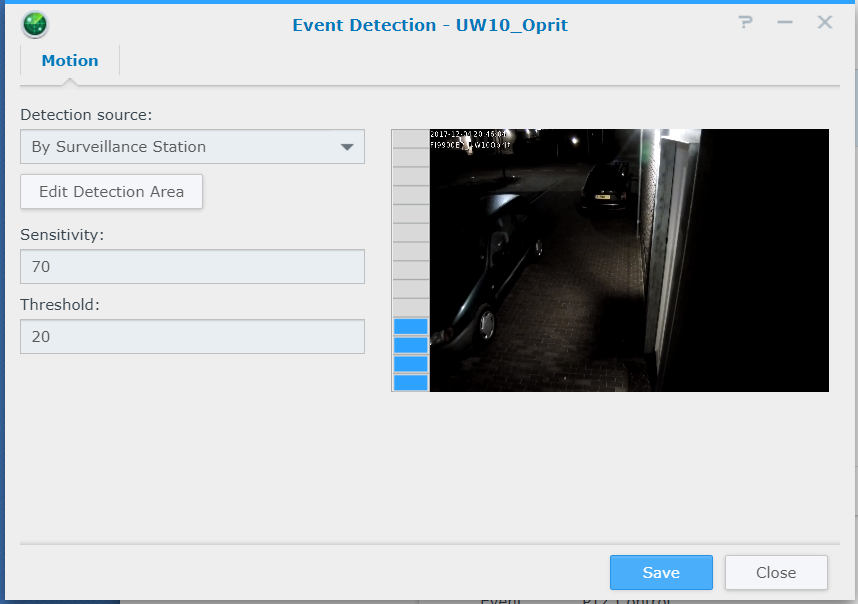

1. Add camera to synology surveillance station
2. Select Applications (in IP Camera screen below your camera) 3. Setup Motion detection here, example of my config (in detection area perform select all or you can set a specific area of the image to monitor) 4. Motion detection setup, let's trigger Domoticz. Make sure you've made a virtual motion detection switch with an off delay of something like 10 seconds and note it's ID

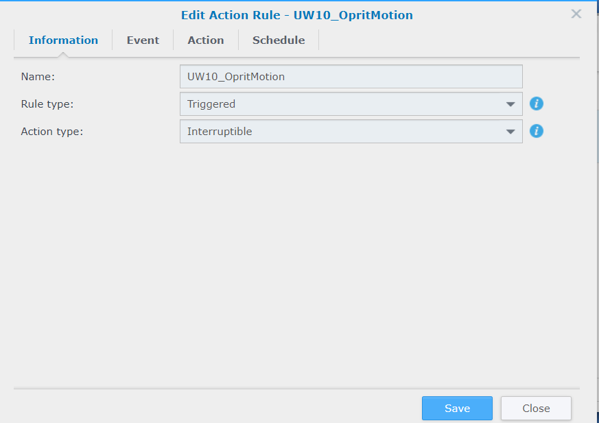

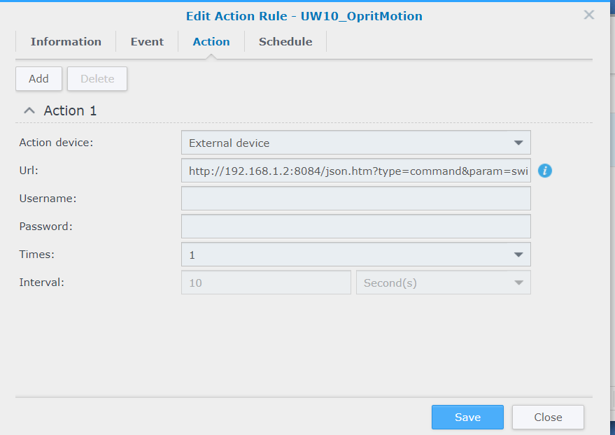

5. Select 'Action Rule' in Surveillance station and configure this with your switch's url URL example:
More screenshots in next post
--edit, change from hint into more extensive description as requested --
http://[IP_ADDRESS_DOMOTICZ]:[PORTNR]/json.htm?type=command¶m=switchlight&idx=[SWITCH_ID]&switchcmd=On

remaining screenshots for step 5
