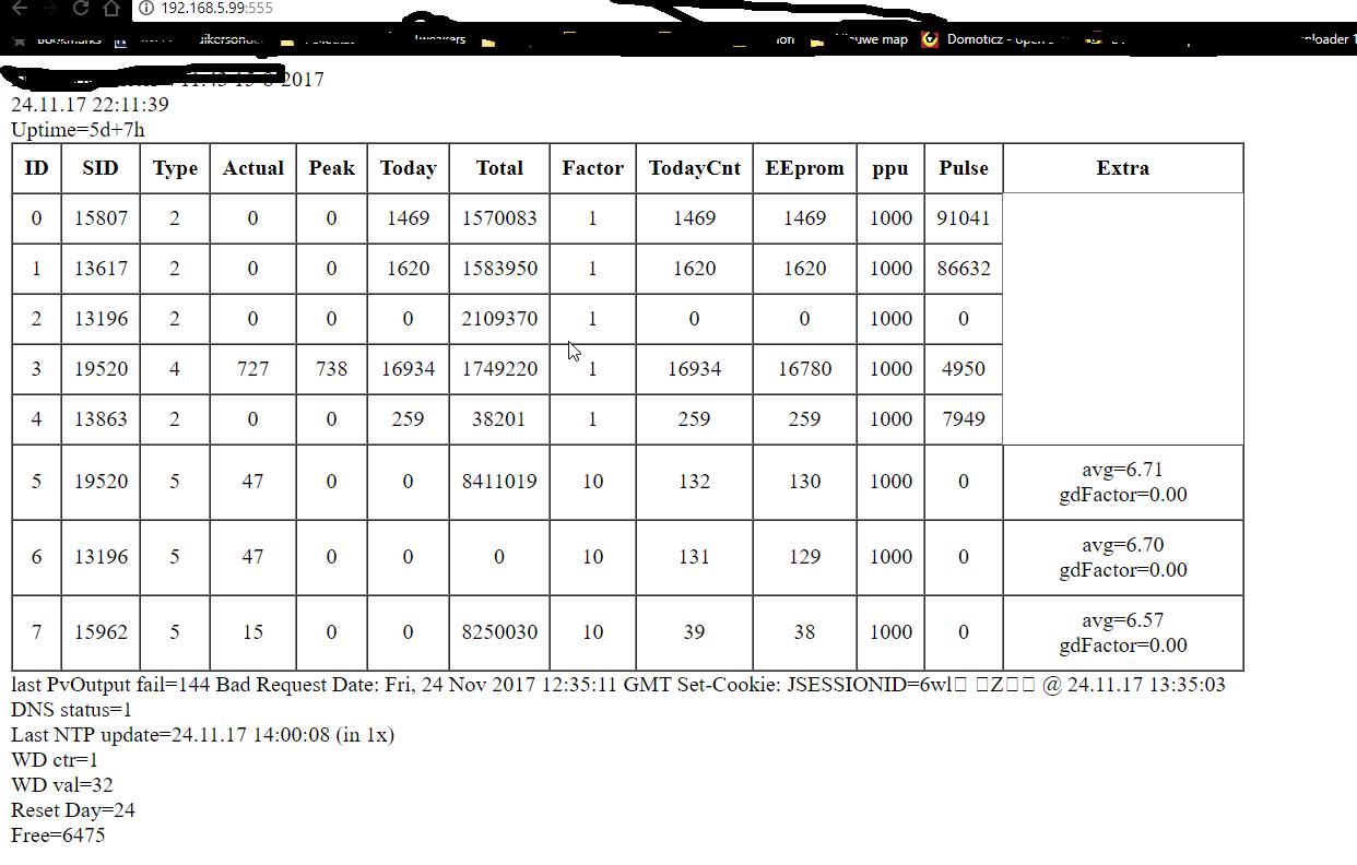

2017-11-24 22:11:02.019 (D.M.: Xiaomi Gateway) Temp (X: Ter)
Only the ip port is alive:
Or do i need a reboot or something??

The script says dead..
Only this 3 are alive
