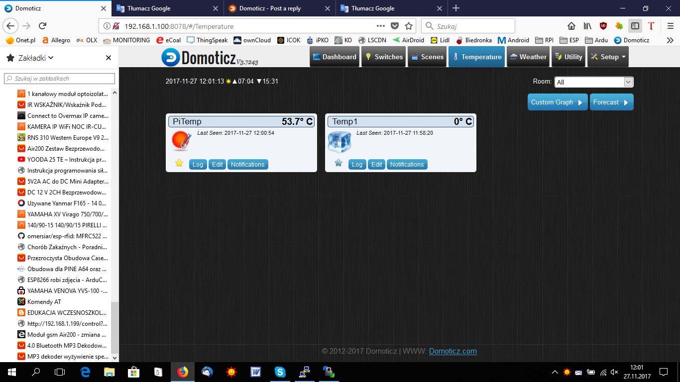

I'm trying to implement this script but it does not show me the temperature.
Sensor updates but nothing else
Sensor ID and IDX from Domoticz I have inserted correctly
Maybe some error in the script is

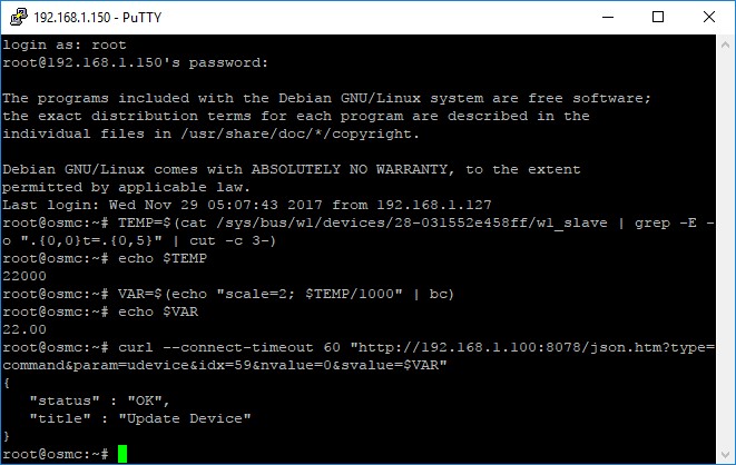

Uh, I am not using this anymore, but I am trying to help.
What is the output of:
TEMP=$(cat /sys/bus/w1/devices/28-00000463dd89/w1_slave | grep  -E -o ".{0,0}t=.{0,5}" | cut -c 3-)
echo $TEMP
VAR=$(echo "scale=2; $TEMP/1000" | bc)
echo $VAR
curl --connect-timeout 60 "http://192.168.1.54:8080/json.htm?type=command&param=udevice&idx=51&nvalue=0&svalue=$VAR"

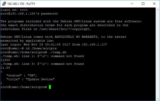

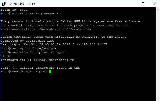

Unfortunately it does not work
It only works if I manually make each line separately
When you add 1.3 at the end of the line ";" works but the console reports errors
TEMP=$(cat /sys/bus/w1/devices/28-031552e458ff/w1_slave | grep -E -o ".{0,0}t=.{0,5}" | cut -c 3-);
echo $TEMP
VAR=$(echo "scale=2; $TEMP/1000" | bc);
echo $VAR
curl --connect-timeout 60 "http://192.168.1.100:8078/json.htm?type=command&param=udevice&idx=59&nvalue=0&svalue=$VAR"

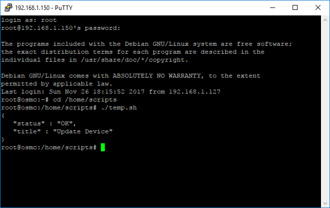

Everything works.
It helped:
Resolved with Notepad++ :
1) Menu->Edit->EOL Conversion -> Unix/OSX Format
2) Then Save
Fixed
