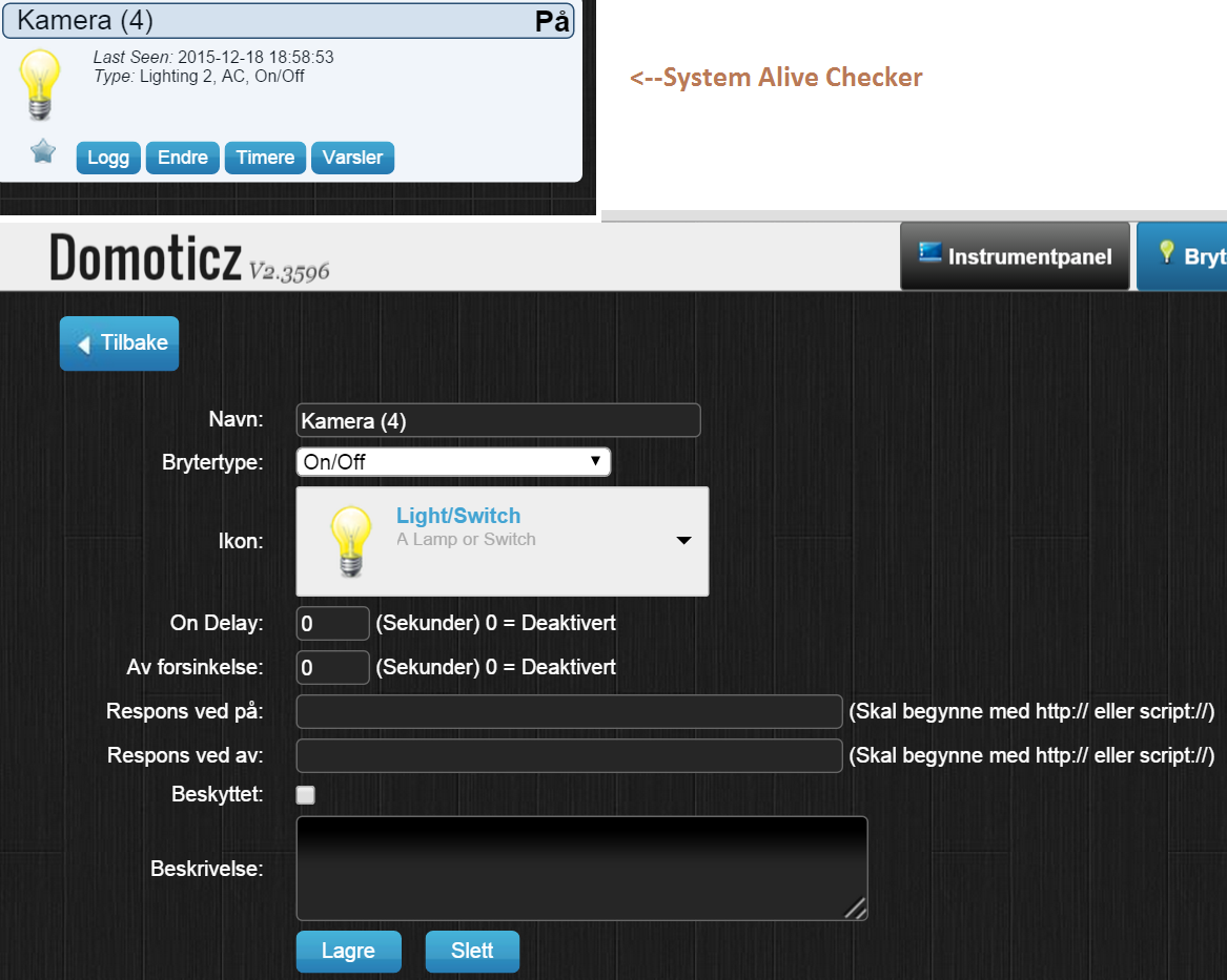

Found a better way to do this.
using a Ping Hardware switch (pinging my camera IP) then attaching the camera to the new Ping/Switch
this will show real status that the camera is online and viewable.. I love it.

Re: Camera domoticz
Post by Evelen »
spudgunman wrote:Found a better way to do this.
How? :P

Re: Camera domoticz
Post by Evelen »
ok, what now?
