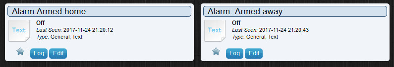

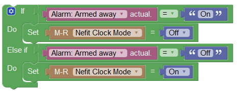

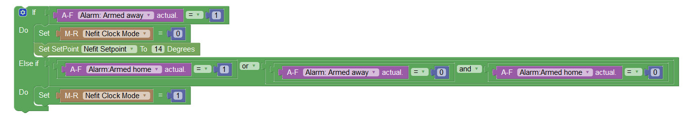

I'm trying to set my nefit to manual mode and lower the temperature to 14 when the alarm is on (only when away) and back to automatic when alarm is off (or in home mode) but I can't get it to work, actually I can't do anything on the status of the alarm, even tried to just send an email when switching on. I only tried in blockly since I don't know how the scripts work. But the states are text variables (they do change correctly), not 0/1 variables, maybe that has something to do with it? I tried in various ways but no luck yet, anyone has some hints? :-)

Maybe try switch device (instead text).
All partitions have one switch for arm/disarm partition
Fantom

I can't change the device type of the armed status, they are by default "text", same is for all outputs, all inputs are alerts with a numeric value (1=ok, 3=violation), only arming is a switch, but I cannot use that because then I still do not know when it is in home or away mode.

I do notice that in the actual values there is no state, only in sValues (whatever that is) so I guess it ain't going to work in blockly...

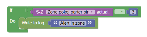

Info for Satel Users.
For Alert Devices (for example for Satel Integra) works this simple script:
