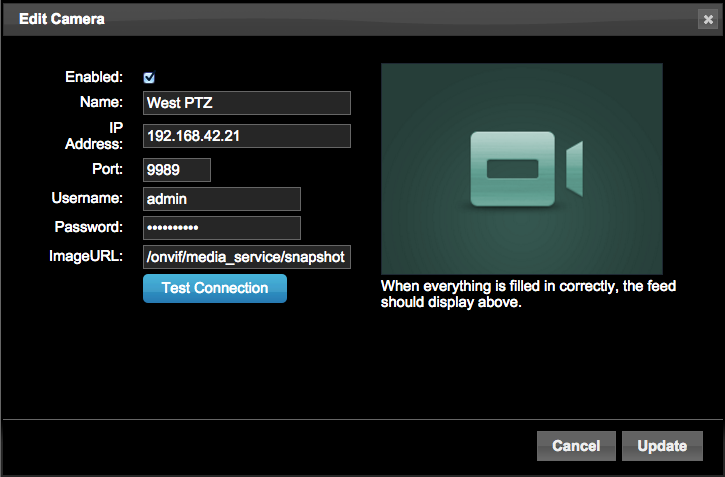

Attached is a screenshot of the config for my Dahua cameras, Ive got four different models and they all use the same config. I dont have anything after snapshot.
Please notice, the preview always shows a broken image when I press test connection.. but otherwise the cameras work perfectly fine, so if your using the test button only to check if its working then you will believe its not functioning, when it likely is.

I also use the Dahua IPC-HDBW4431R-ZS.
To get a snapshot, I can use
http://10.0.0.30/cgi-bin/snapshot.cgi?1
but then I have to type user and password.
I could not found a version where I add user and password to the URL.
Any ideas ?
Any ideas ?

@howi42
Can you try;
http://user:[email protected]/cgi-bin/snapshot.cgi?1
I believe I have the similar camera and use;
protocol:HTTP
port: 80
imageURL : cgi-bin/snapshot.cgi?1
Test connection does not work, but the image is shown in the overview page.
Otherwise check if you can downgrade the authentication in the camera config itself from digest to basic. (Assuming you have not connected this to the internet).
Can you try;
protocol:HTTP
port: 80
howi42
- Posts: 8
- Joined: Sunday 18 October 2015 2:05
Re: Dahua Ip camera snapshot url
Thanks, but it did not work.
And, I do not see a way to change form digest to basic.
A workaround could be to trigger an alarm manually; that would create a snapshot I could use.
But I am not sure if this can be done.
