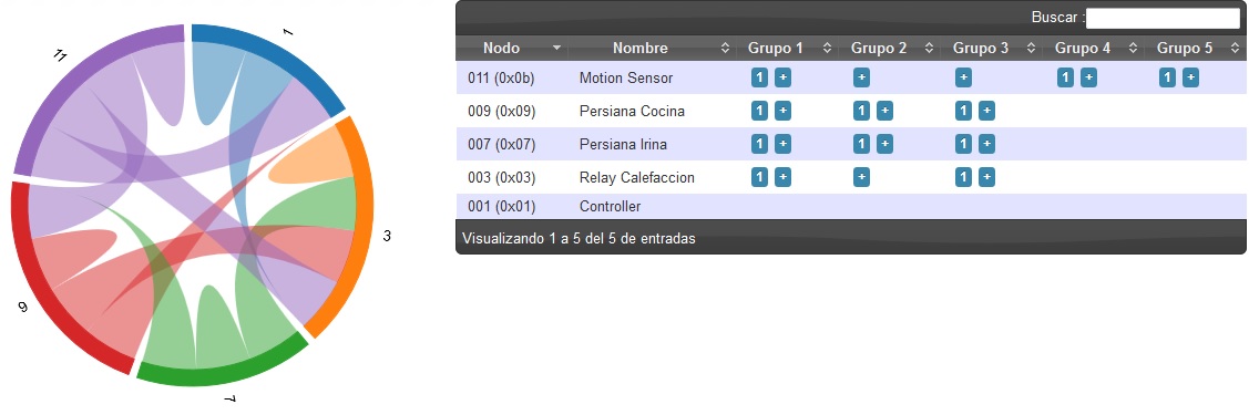

My apologies. It seems that my problem was the range. Although the FGS222 [Id 3] is probably the closest routing device, may be it is routing the traffic to the other devices and if it fails, the other devices loose the network.
[Id 9] is other routing device but i guess it is loosing the connection directly to the controller randomly, so i sometimes lost the connection only to the FGS222 and other times lost to all devices (less Id 11 that is battery powered and closer to the controller).
In some tests to attach a Weather Station by usb, i moved a little the controller, and that was when my problems started. Now I have two days with the network stable.
I have one question: is there any way to show the range in % or other values to get an idea of the good/bad network range of devices?
I guess the thin/fat lines of connections between devices in the network panel is an idea, but to be more specific, where can i get those values?
Kind regards,
Kind regards,
- Network.jpg (82.31 KiB) Viewed 4664 times
