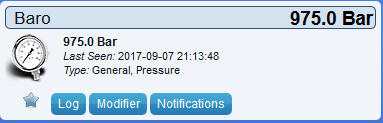

hello
I added 2 probes temperature hygrometry barometer aquara.
everything goes well with the temperature and hygrometry.
the problem concerns the barometer. In the app MIHOME I have 97.5 kPA (0.975 bar) while in domoticz I have 975 bar.
can we change the units somewhere in dz to fix that?
furthermore the barometer device is found in the measurement tab instead of the weather tab?
