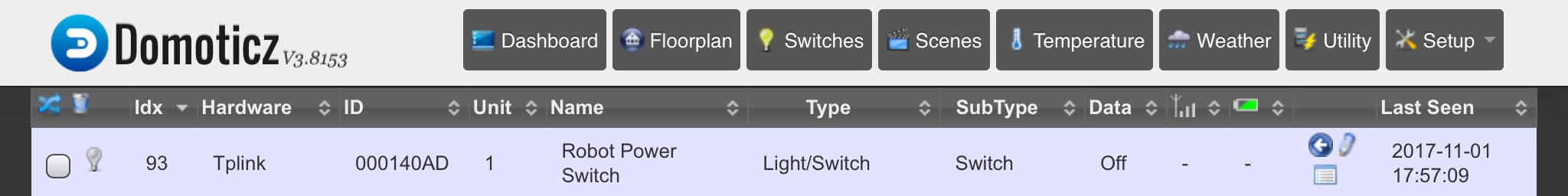

Thanks - could you give me a screengrab from Devices? So Setup>Devices? I need the type/subtype

sgeaglef15
- Posts: 12
- Joined: Monday 21 August 2017 15:17
Re: Easy Domoticz to Alexa Integration
Hi, here u goMadgeni wrote: Wednesday 01 November 2017 14:26 Thanks - could you give me a screengrab from Devices? So Setup>Devices? I need the type/subtype
- 8EDDF6B9-7E6C-4493-BFA4-24D3D1D9B89D.jpeg (102.3 KiB) Viewed 6136 times
Madgeni
- Posts: 1571
- Joined: Friday 25 March 2016 17:43
ok, so that's odd, it should be there. Can you PM your email address, and i'll see what's up

Madgeni
- Posts: 1571
Can you just double check that the device is in a Room Plan?sgeaglef15 wrote: Wednesday 01 November 2017 14:24 Hi Madgeni,
Here you go, please see attachment.

sgeaglef15
- Posts: 12
Hi Madgeni,Madgeni wrote: Wednesday 01 November 2017 17:18Can you just double check that the device is in a Room Plan?sgeaglef15 wrote: Wednesday 01 November 2017 14:24 Hi Madgeni,
Yes it in the living room room plan and as well as overall floor plan.
It is an active switch (I can actuate the switch from the floor plan, just Alexa cannot see it)
sgeaglef15
- Posts: 12
Hi Madgeni,
One thing I like to point out most of my switches (switch > Xiaomi Gateway > domoticz)
This tp link switch is slight different (switch > domoticz direct [as a virtual switch])

Madgeni
- Posts: 1571
Hi @joshmosh -
i don't believe you can access Humidity at the moment - as soon as new functionality is available, i'll make sure it's in there.
@sgeaglef15 - can you PM your email address, and i'll take a look

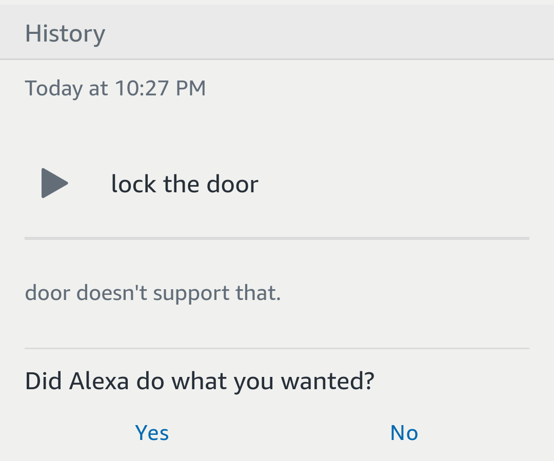

farhanito
- Posts: 34
- Joined: Friday 19 August 2016 5:39
hi @madgeni,
what's proper device type/subtype for a door lock? it's a Yale ZigBee doorlock (as dummy switch)
this is the only thing that isn't working for me..
- Screenshot_2017-11-02-22-35-57-641_com.amazon.dee.app.png (53.88 KiB) Viewed 6002 times
- Screenshot_2017-11-02-22-34-54-670_com.amazon.dee.app.png (51.1 KiB) Viewed 6002 times
