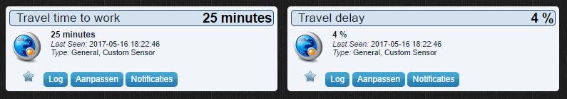

Created a very small plugin that let's you monitor travel times and delays (by car only for now) between A and B. Yeah I know, not so much to do with smart home he.
What you get:
  • Sensor with current travel time in minutes (i.e. if you would leave right now)
  • Sensor with percentage delay in relation to normal traffic for that time of the day

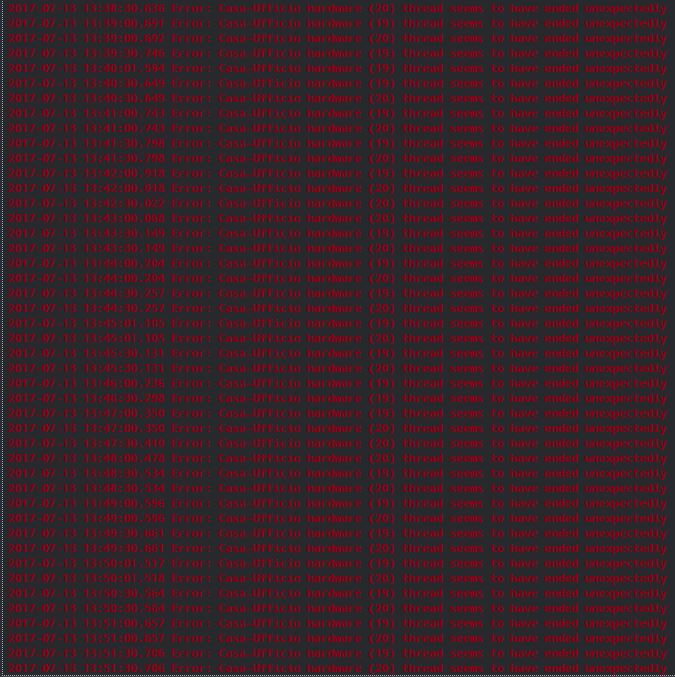

I set the interval at 300 seconds. But almost every 30 seconds I get in my domoticz logging:
Error: Reistijd hardware (28) thread seems to have ended unexpectedly
Reistijd is the name I gave it.
any clue?

qwerk wrote:Hi, I installed this plugin.
It is really nice.
any clue?
It's a bug in Domoticz if you have large heartbeat intervals.

The only annoying thing is the repeating message in the log saying
"2017-07-12 17:55:13.479 Error: Travel (16) thread seems to have ended unexpectedly"
Every 30 seconds.
Nothing that can be done about this? I don't want to run it less than every 300 seconds.

Plugin works,sensor will be update but the log is full of error!
Andree
Posts: 74
Joined: Wednesday 07 June 2017 11:19
Re: Plugin: Travel Times
Post by Andree »
Andree wrote: Thursday 13 July 2017 13:57 Plugin works,sensor will be update but the log is full of error!
Help!
