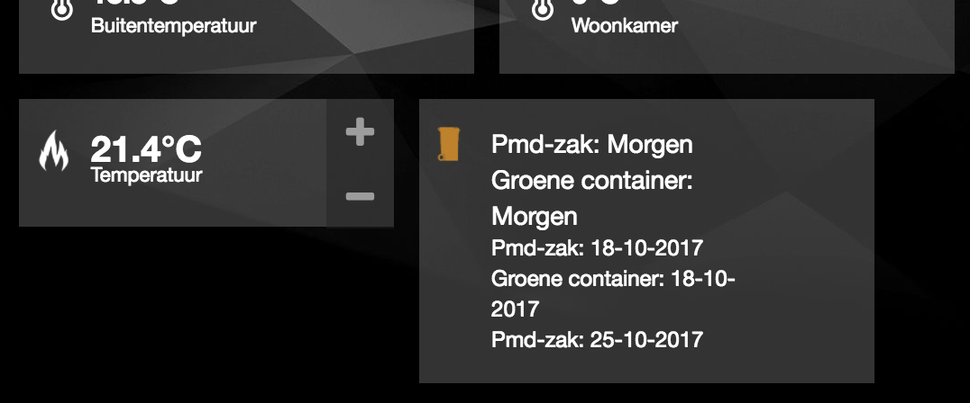

htilburgs
Posts: 464
Post by htilburgs »
wvries wrote: Tuesday 10 October 2017 15:29 Hi all,
I have a panel setup with 3 columns, working perfect.
One column has now a few blocks in it (and 3 x 4 is nicely aligned).
However, I also have 1 row that has a width of 5 and one of 6.
That shows the last block a little off the edge.
My question is, is there a method to create an "empty" block that ahs a variable width, that i can place in between the 2 blocks ?
for example:
Block 1 (width = 5) - Empty (width = 1) - Block 2 (width 6) = 12
Hope it makes sense :-)
I had the same issue and solved it like this.
- Created a dummy switch in domoticz
- Created a block in config.js
blocks[440] = {} //Dummy Leeg
blocks[440]['title'] = '';
blocks[440]['width'] = 1;
blocks[440]['icon'] = '';
blocks[440]['hide_data'] = true;
blocks[440]['protected'] = true;
- Made block complete transparent in custom.css
.mh.transbg.block_440.col-xs-1 {		/* if widht = 1 then col-xs-1, width=2 then col-xs-2, etc... */
	background: rgba(0,0,0,0);		/* rgba(0,0,0,0); makes transparent */
Added this block behind my thermostat within the columns definition and now there is an empty space!
I hope this works for you.

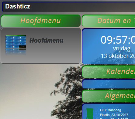

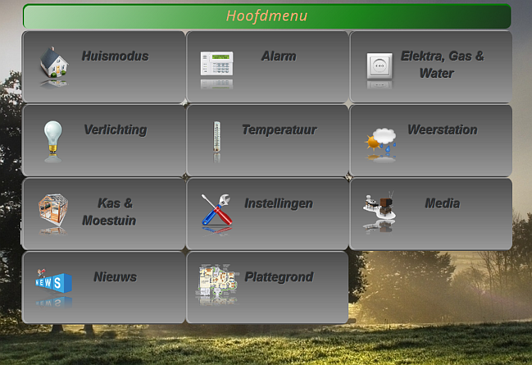

yfands
Posts: 67
Joined: Monday 04 July 2016 10:16
Domoticz version: latest B
Post by yfands »
Hai Rob,
Nice work, I like Dashticz very much.
But I have way to many 'items' for 1 dashboard, so by creating more dashboards (screens) I'll keep swiping, so In my opinion there was only one thing missing, a mainmenu, I can now jump to the desired screen by a click/touch.
So with a little change in main.js I was able to create a menu with buttons, once clicked/touched will slide to the desired screen.
Maybe another option for Dashticz, but I like to see it in an ordered fashion, something in Config.js saying var Menu{} etc..
Or maybe keep the dashboard 'look', and create a mainmenu in the topbar.
Mainmenu
Mainmenu
Screenshot-2017-10-13 Dashticz (1).png (312.74 KiB) Viewed 7191 times
Mainmenu button on other screens
Screenshot-2017-10-13 Dashticz (2).png (239.6 KiB) Viewed 7191 times
This is what I did.
Main.js
(near) line 551 (version depended) add/change the folowing lines with new marker:
I wasn't succesfull on using the 'key' option so data-id etc can be removed, but I leaf it for furhter testing
new if(typeof(button.slide)!=='undefined'){
new var html='<div class="col-xs-'+width+' hover transbg Menu" data-id="buttons.'+key+'" onclick="toSlide(\''+button.slide+'\')">';
new }
new else {
if(typeof(button.newwindow)!=='undefined'){
var html='<div class="col-xs-'+width+' hover transbg" data-id="buttons.'+key+'" onclick="window.open(\''+button.url+'\')">';
else {
var html='<div class="col-xs-'+width+' hover transbg" data-id="buttons.'+key+'" data-toggle="modal" data-target="#button_'+b+'_'+random+'" onclick="setSrc(this);">';
new }
Config.js
var buttons = {}
buttons.hoofdmenu= {width:12, image: 'img/hoofdmenu_mirror.png', title: 'Hoofdmenu' ,slide:0 }
buttons.huismodus= {width:4, image: 'img/house_mirror.png', title: 'Huismodus' ,slide:1 }
buttons.alarm= {width:4, image: 'img/alarmpanel_mirror.png', title: 'Alarm',slide: 2}
buttons.utility= {width:4, image: 'img/power_mirror.png', title: 'Elektra, Gas & Water' ,slide:3 }
buttons.verlichting= {width:4, image: 'img/Light-off_mirror.png', title: 'Verlichting',slide: 4}
buttons.temperatuur= {width:4, image: 'img/temp_mirror.png', title: 'Temperatuur' ,slide:5 }
buttons.weerstation= {width:4, image: 'img/weer_mirror.png', title: 'Weerstation',slide: 6}
buttons.kas_en_moestuin= {width:4, image: 'img/kas_mirror.png', title: 'Kas & Moestuin' ,slide:7 }
buttons.instellingen= {width:4, image: 'img/settings_mirror.png', title: 'Instellingen',slide: 8}
buttons.media= {width:4, image: 'img/media_mirror.png', title: 'Media' ,slide:9 }
buttons.nieuws= {width:4, image: 'img/nieuws_mirror.png', title: 'Nieuws' ,slide:10 }
buttons.plattegrond= {width:4, image: 'img/floorplan_mirror.png', title: 'Plattegrond' ,slide:11 }
//buttons.domoticz= {width:3, image: 'img/weer_mirror.png', title: 'Weather',slide: 0}
//Column[0] contains the 'goto mainmenu' button, so add column[0] on every screen.
columns[0] ={}
columns[0]['blocks']=['bt_Hoofdmenu',buttons.hoofdmenu]
columns[0]['width']=2;
//with columns[1] [2] [3] I define the first screen, the mainmenu
columns[1] = {}
columns[1]['width'] = 3;
columns[2] = {}
columns[2]['blocks'] = ['bt_Hoofdmenu',buttons.huismodus, buttons.alarm, buttons.utility, buttons.verlichting, buttons.temperatuur, buttons.weerstation, buttons.kas_en_moestuin, buttons.instellingen, buttons.media, buttons.nieuws, buttons.plattegrond]
columns[2]['width'] = 6;
columns[3] = {}
columns[3]['width'] = 3;
/*'bt_Hoofdmenu' is a blocktitle*/
Custom.css
.Menu{
padding: 10px 10px !important;
color: Black;
font-size: 40px !important;
font-style: Italic;
text-align: center;
line-height: 0.7em;
background: rgba(0, 0, 0, 0) linear-gradient(#4d4d4d, #999999) repeat scroll 0 0 !important;
box-shadow: inset 1px 0px 0px 0px rgba(255,255,255,0.5) !important;
/* add background and box-shadow for other browsers*/
.Menu .title
color: rgba(48,48,48,1);
font-size: 20px !important;
font-weight: 700;
font-style: Italic;
//letter-spacing: 1px;
padding-left: 20px;
line-height: 0em;
line-spacing: 0em;
text-shadow: 1px 1px 0 rgba(140,140,140,0.6) , -1px -1px 1px rgba(0,0,0,0.67);
.Menu .buttonimg
max-height:75px;
.Menu .col-xs-1,
.Menu .col-xs-2,
.Menu .col-xs-3,
.Menu .col-xs-4,
.Menu .col-xs-5,
.Menu .col-xs-6,
.Menu .col-xs-7,
.Menu .col-xs-8,
.Menu .col-xs-9,
.Menu .col-xs-10,
.Menu .col-xs-11,
.Menu .col-xs-12 {
padding-top: 10px !important;
padding-right: 2px !important;
padding-left: 2px !important;
Frank

Neat... /me wants it.

htilburgs wrote: Thursday 12 October 2017 10:21
for example:
good idea, didn't though of that.
will do and check. thanks for this.
