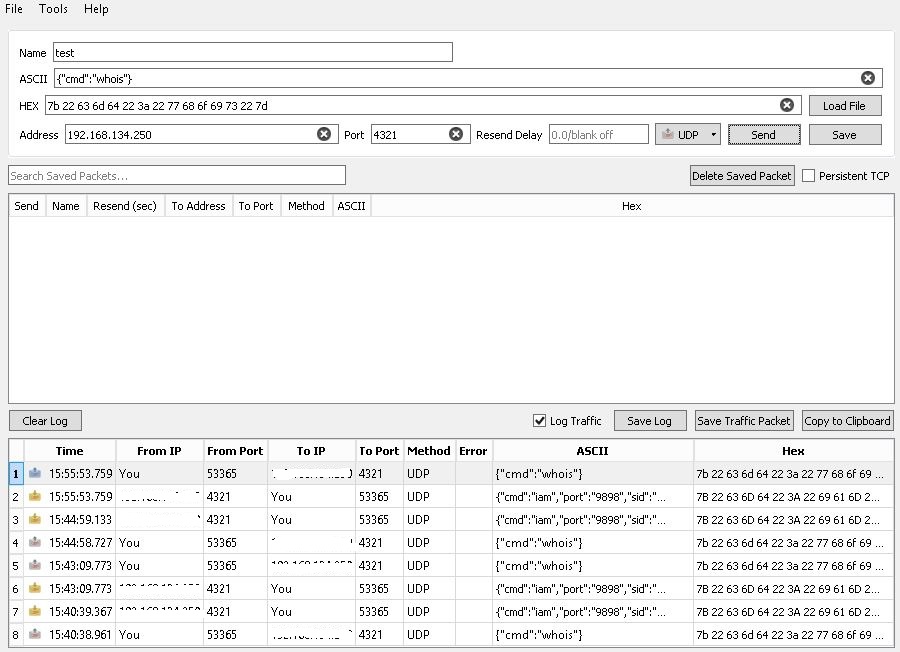

Imagehi, sorry if i have a old question, but i not can add gateway in domoticz...i have all port open but the reponse of domoticz is
XiaomiGateway: will listen on 9898 for hardware id 4
XiaomiGateway: Delaying worker startup...
XiaomiGateway: Worker started...
domoticz is install in windows 2012R2 server on my pc at office. The pc is connected in LAN (cabled). In to the pc if i ping the gtw it respond. I have test udp port with packet sender and the risult is attached.
Can you help me? i have reinstall the app to the my Android phone but nothing, nothing seems to work

fabiotodesco wrote: Tuesday 03 October 2017 16:12 Imagehi, sorry if i have a old question, but i not can add gateway in domoticz...i have all port open but the reponse of domoticz is
To test this, you should be sending to the multicast address 224.0.0.50, not 192.168.134.250. I'm guessing you tried that first but changed to the actual device IP because the multicast address wasn't working, and if that is the case it is probably your Windows firewall blocking it, or your router/network configuration not working with multicast.

Post by fabiotodesco »
corbin wrote: Wednesday 04 October 2017 11:11
HI, thanks for te answer but the firewalll of windows is disable, but i have a mikrotik firewall thath control the network. i don't understand this multicast story can you explain me?
Thanks a lot

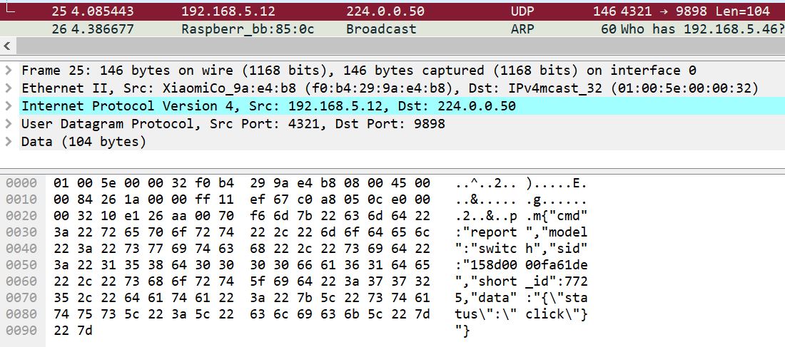

fabiotodesco wrote: Wednesday 04 October 2017 13:22 HI, thanks for te answer but the firewalll of windows is disable, but i have a mikrotik firewall thath control the network. i don't understand this multicast story can you explain me?
Thanks a lot
Can't help you specifically with your hardware, but you can test on your windows pc by running wireshark and see if the UDP packets are visible on your network. Example of a UDP packet when clicking a Xiaomi button:
