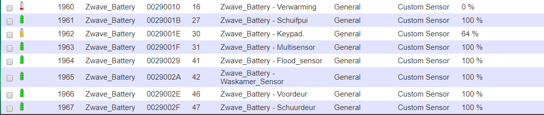

remb0
Posts: 499
Re: Python plugin: Battery Level for Z-Wave Devices
Post by remb0 »
thanks! great work!
maybe an idea to make a compatible list?
I have:
Neo CoolCam Power plug 12A+
Aeotec ZW089 Recessed Door Sensor Gen5+
Neo CoolCam Battery Powered PIR Sensor+
Neo CoolCam Water Leakage Detector+
Schlage Link Mini Keypad RFID
Philio Technology Corporation PST02-A 4 in 1 Multi-Sensor+
Danfoss Z Thermostat 014G0013
as you can see in my screenshot ony the danfoss is working:) the battery was really empty.
the zipato keypad mini in domoticz known as (Schlage Link Mini Keypad RFID) is 64. but this is already a few months so I don't believe it's right.
and in openzwave panel there is no info about the battery stats of the zipato.
are the other devices not compatible with battery info or do I have them wrong configured?
