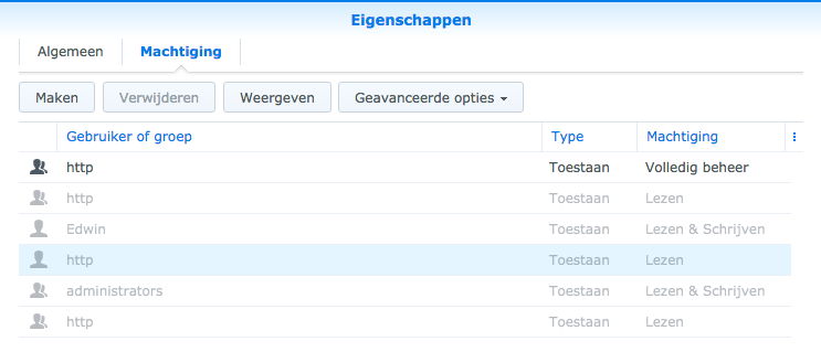

(for users with issues, I'm running Dashticz on my Synology nas, made the file write-able for the 'http' user by right clicking on the file in 'File Station')

pvm wrote: Tuesday 03 October 2017 15:08 (for users with issues, I'm running Dashticz on my Synology nas, made the file write-able for the 'http' user by right clicking on the file in 'File Station')
You mean, like this?

pvm
Posts: 550
Domoticz version: 4.10538
Re: Dashticz - Save CONFIG.js automatically with PHP
Post by pvm »
Yes, hope it helps you. Can you change the dashboard title now?
