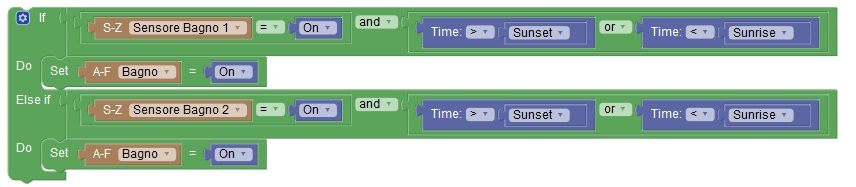

GOAL:use two presence sensor for set ON a Light and set OFF if both sensor are off.
i've create this blocky for light ON and that work well,if both or only one sensor finds presence set the lights ON.
Auto ON Bagno.jpg (50.93 KiB) Viewed 3802 times

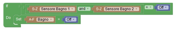

Now,i've create another blocky for set light OFF when BOTH sensor are OFF but this don't work and the light remain ON forever
AutoOFF Bagno.jpg (18.7 KiB) Viewed 3802 times
I do not understand why not work, it seems easy!

First: you better create one Blocky for it and make a second 'Else if'. Not necessary, but may give you some more overview.
Second: You can't make two sensors 'and' without an condition. So you have to create IF <Sensore Bagno 1 = Off> and <Sensore Bagno 2 = Off> SET <Bagno = Off>
By the way, you may also check if Bagno is already on/off. This way Domoticz won't send an On or Off signal every second. So IF <Sensore Bagno 1 = Off> and <Sensore Bagno 2 = Off> and <Bagno = On> SET <Bagno = Off>

Looks good to me, but maybe you can add <Bagno = Off> to the first two rows. Because right now Blocky is constantly setting Bagno = On, where it is only needed to set Bagno = On while Bagno = Off.

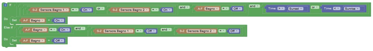

Re: Problem With Simple Blocky
Post by TyzzyT »
This seems correct, you may also simplify it to have only one row for setting Bagno = On.
You can create:
If <<Sensore Bagno 1 = On> OR <Sensore Bagno 2 = On>> AND <<Time >Sunset> or <Time <Sunrise>> AND <Bagno = Off>
Do Set Bagno = On
Make sure you nest Sensore Bagno 1 & 2 in ONE block. And to nest Time in ONE block (like you already have).
ilpier
Posts: 31
Joined: Friday 24 February 2017 12:01
Post by ilpier »
Ok,if i understanf now it's the best way for my goal?
TyzzyT
Posts: 32
Joined: Saturday 11 March 2017 11:06
Domoticz version: 3.5877
Post by TyzzyT »
Looks good to me!

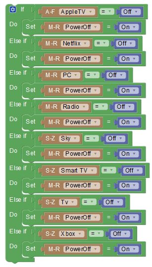

Sorry...i've another problem and i try to explain,it's not simple in my bad english!
In DomoticZ i've add Logitech Harmony Control and all work fine BUT there is one switch "poweroff" for PowerOff all activity.
I wish that turning off a switch, for example, the "XBOX" switch became active the "POWEROFF" switch in automatic.
i've create that blocky but if i change activity,for example,XBOX to AppleTV,that blocky active PowerOFF before of AppleTV!
The solution for me is "IF (all activity = OFF for 3 second) -> SET -> (PowerOFF = ON)" but i can't add function "FOR 3 SECOND"!
StanHD
Posts: 347
Location: East Sussex, UK
Post by StanHD »
Do you want power off when all other switches are off? If yes then you just need something like:
If ([AppleTV]=Off) and ([Netflix]=Off) and ([PC]=Off) ........ etc.
Do Set ([PowerOff]=On)

Hi to all,my problem with Harmony Remote still alive!!
With this blocky sometime the new activity start in delay and the blocky active PowerOFF before.
There is no way for add "For X Second"?
