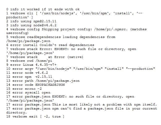

I am a beginner started with domoticz 8 weeks ago. Now after all my lights are integrated I am looking for sonos.
Did installation following step by step guide but failed.
Can anyone please help me?
Thanks.
Thanks.

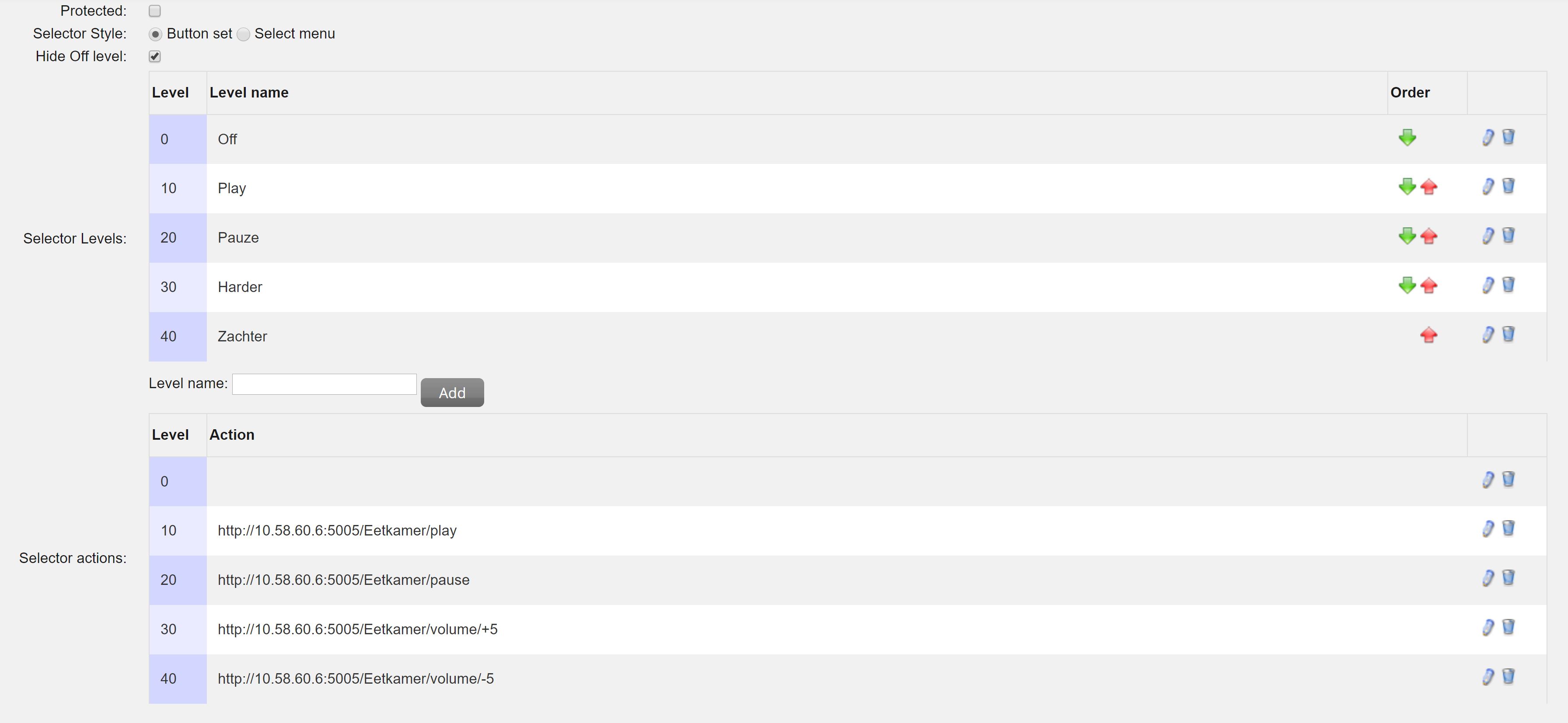

Re: Step by step guide: Sonos integration
Is new enough.
Can you check again, if your setup similar to the below;
