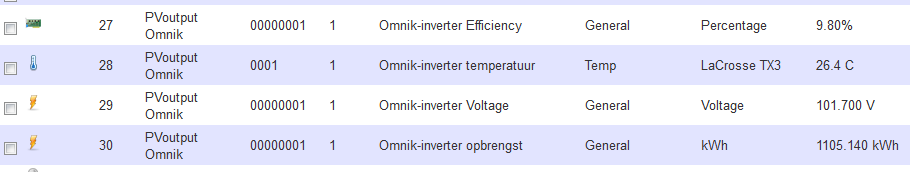

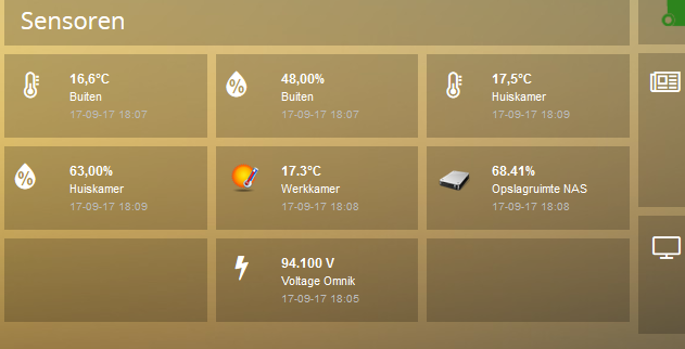

ImageI would like to show the values of my solarpanels. They are logged to PVoutput. In Domoticz I got IDX 27 till 30.
IDX Omnik.PNG (13.08 KiB) Viewed 5139 times
But when i define blocks with this IDX and put them at the end of column 1
blocks[28] = {}
blocks[28]['title'] = 'Temp Omnik';
blocks[28]['width'] = 4;
blocks[29] = {}
blocks[29]['title'] = 'Voltage Omnik';
blocks[29]['width'] = 4;
blocks[30] = {}
blocks[30]['title'] = 'Opbrengst Omnik';
blocks[30]['width'] = 4;
columns[1] = {}
columns[1]['blocks'] = ['blocktitle_1',31,110,10,55,11,18,9,14,477,'blocktitle_2',377,93,512,3,28,29,30]
columns[1]['width'] = 5;
I get 2 empty bloks in Dashticz and only the block with Voltage shows oke.. :roll: In Domoticz no problems.. Anybody with an solution?
Empty blocks pvoutput.PNG (79.82 KiB) Viewed 5139 times

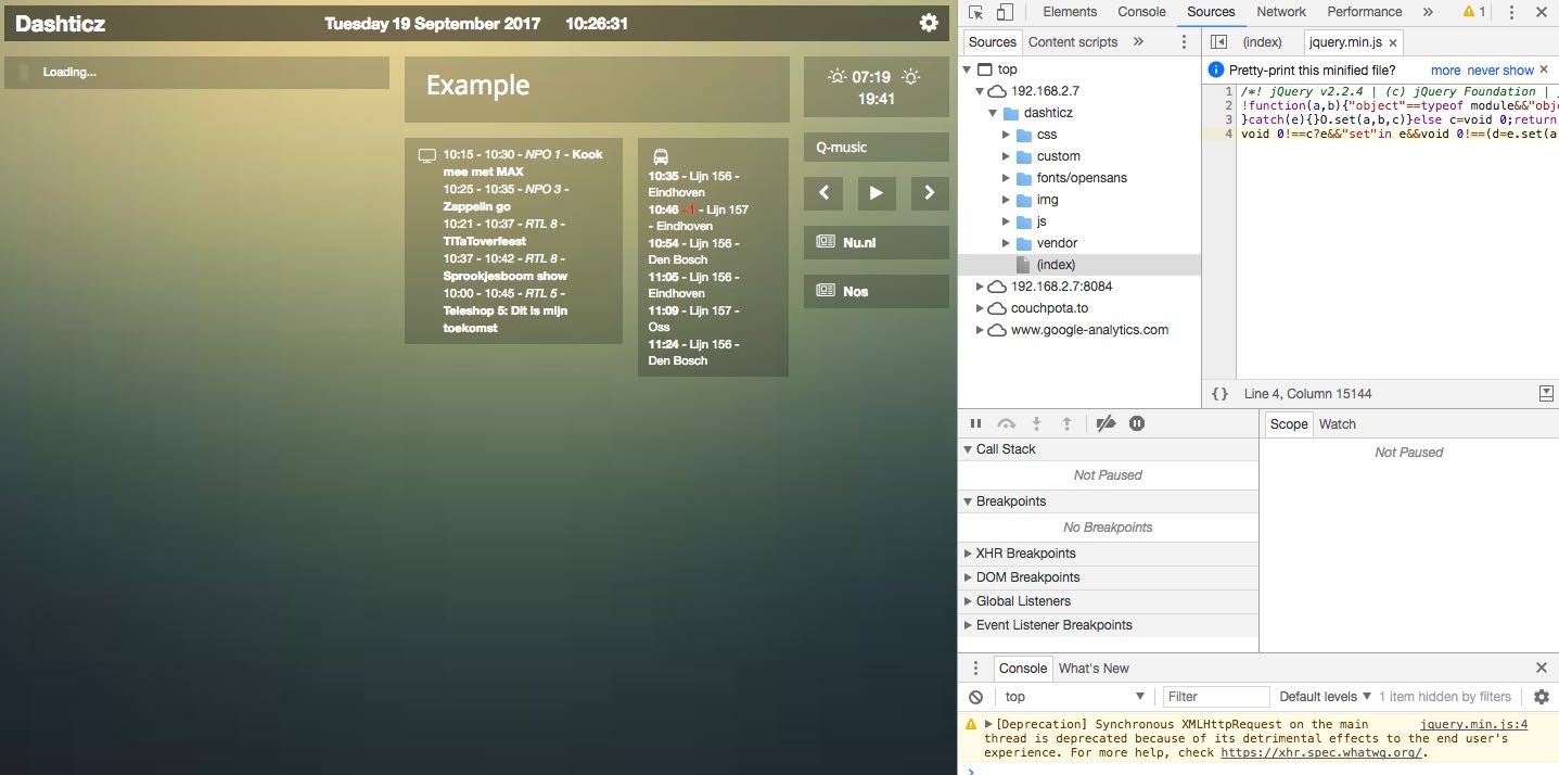

Can someone help here, I really do not know why I keep on getting a blank page. I have altered the CONFIG.js as per instructions, still no luck after a dozen retries or so... (even if I change my IP to a non existent one it keeps on getting an empty page, so I would reckon it cannot logon correctly on domoticz or something like that). Thanks for your time...
This is my CONFIG.js (I left username and password, there I fill in the ones I uses to logon to Domoticz)
var config = {}
config['domoticz_ip'] = 'http://username:[email protected]:8084';
var trashnames = {}
trashnames['Gft'] = 'GFT';
trashnames['Pmd'] = 'Plastic';
trashnames['Rest'] = ''; //LEAVE EMPTY IF YOU WANT TO HIDE IT
var publictransport = {}
publictransport.ovinfobus = { show_via: false, station: 'son-en-breugel/bushalte-penseelkever', provider: '9292-bus', icon: 'bus', width:5, results: 6 }
var tvguide = {}
tvguide.dutch = { key:'dutch', icon: 'fa-television', width:7, channels: [1,3,4,31,46,92], maxitems: 5 }
var _STREAMPLAYER_TRACKS  	= [
	{"track":1,"name":"Q-music","file":"http://icecast-qmusic.cdp.triple-it.nl/Qmusic_nl_live_96.mp3"},
	{"track":2,"name":"538 Hitzone","file":"http://vip-icecast.538.lw.triple-it.nl/WEB11_MP3"},
	{"track":3,"name":"Slam! NonStop","file":"http://stream.radiocorp.nl/web10_mp3"},
	{"track":4,"name":"100%NL","file":"http://stream.100p.nl/100pctnl.mp3"},
var buttons = {}
buttons.nunl = {key: 'nunl',  width:12, icon: 'fa-newspaper-o', title: 'Nu.nl', newwindow:true, url: 'http://www.nu.nl'}
buttons.nos = {key: 'nos',  width:12, icon: 'fa-newspaper-o', title: 'Nos', url: 'http://www.nos.nl'}
var blocks = {}
blocks['blocktitle_1'] = {}
blocks['blocktitle_1']['key'] = 'blocktitle_1';
blocks['blocktitle_1']['title'] = 'Example';
var columns = {}
columns['bar'] = {}
columns[1] = {}
columns[1]['blocks'] = ['currentweather_big','weather','garbage']
columns[2] = {}
columns[2]['blocks'] = ['blocktitle_1',tvguide.dutch,publictransport.ovinfobus]
columns[2]['width'] = 5;
columns[3] = {}
columns[3]['blocks'] = ['sunrise','streamplayer',buttons.nunl,buttons.nos]
columns[3]['width'] = 2;
var columns_standby = {}
columns_standby[1] = {}
columns_standby[1]['blocks'] = ['clock','weather']
var screens = {}
screens[1] = {}
screens[1]['background'] = 'bg2.jpg';
Edit:
Even if I allow Domoticz to acces without password on local address (192.168.2.7) and I leave out the username:password bit in the CONFIG.js it only shows a blank page. Further I noticed some CONFIG files with a lot more (and different coding iso array var config = {} with var _LANGUAGE = nl_NL etc). What is the difference?
btw I use version 3.8153 Domoticz.
UPDATE: my mistake, something went wrong with copying dashticz to webfolder. Not all files had been copied.
Last edited by Peacock on Tuesday 19 September 2017 9:23, edited 3 times in total.

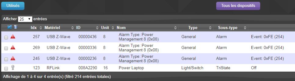

I do not seem to get the Favorites loaded into Dashticz. Can anyone help, I do see one warning in the console, see below.
Schermafbeelding 2017-09-19 om 10.26.24.jpg (113.22 KiB) Viewed 5055 times
EDIT:
When I add custom blocks with a typical switchIDx into the Config, I do get the values.
Schermafbeelding 2017-09-19 om 11.40.43.png (391.85 KiB) Viewed 5034 times

hdpop38
Joined: Thursday 21 September 2017 12:32
Post by hdpop38 »
Hi All,
I started to use Dashticz to see devices of Domoticz. Started it's easy but something not work ( perhaps some seting was fail )
I'm able to see temperature and log of domoticz.
But I not able to see switch devices IDX=123 with this code
blocks[123] = {}
blocks[123]['icon'] = 'fa-female';
blocks[123]['title'] = 'Annie';
And another thing, I not see my favorites devices declared in domoticz
If somebody can help me...
