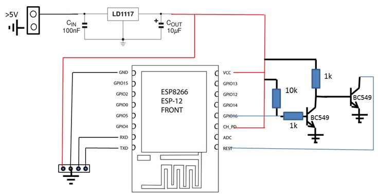

only issue with the ESP unit is that the soft reboot is not always working
so I added a hard reset to pin 16 the setup

Post by Jan80 »
Because I am writing a new firmware for a commercial device (Sonoff Touch) adding parts to the circuit is not an option. But at least you confirmed, that MySensors's sendHeartbeat() function does not work with an gateway device. I hope the devs will have a look at that. ;)
In the meantime I will try to use the sendBatteryLevel() function. This wont add additional devices.
