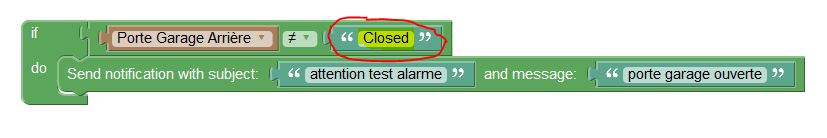

Re: Events system feedback thread
Hello Pierre4fun,pierre4fun wrote:Hello,
The event can be saved under chrome: it works fine. in all configs
THANKS !
I still can't save the event, can you help on this one?
My configuration is:
Raspbian "Wheezy" + Domoticz
Raspberry PI vB
Rfxtrx
Firefox v22
Are there options to activate in the navigator?
__________________________________________________
Update!
It is OK I resolved my problem!
I could not save because the events were not complete.
Thanks again for your support & work!

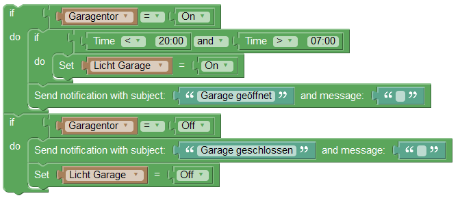

I have found an error...
i tried to make a event that should do this:
1) When open the garage between (22:00 and 07:00) turn on the light in the garage and send an notification.
2) When garagedoor is closed (turn off the light)
PS: To test this, the garagedoor is a Switch-Device and the time is set to between 07:00 and 22:00 In the Log i found this Line after testing:
EDIT:
When i change the event to this: There is now error in the log an an Message was send, the light turned on
But Nothing will happend when the garage is closing. No error in the log, no message an the light is still on.
Error: Sun Jul 14 14:07:02 2013 Lua script error: [string "result = 0; weekday = os.date('*t')['wday']; ..."]:1: attempt to compare nil with numberWhen i change the event to this: There is now error in the log an an Message was send, the light turned on

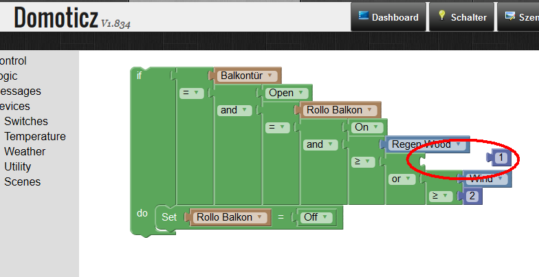

hello
it is not possible to insert a value at the marked spot.
I miss the possibility for countdown timer and on / off delay
- event.png (38.1 KiB) Viewed 8822 times
greetz
wood
wood

I'm going to disable having multiple if-then blocks after another. It is too complex for the moment, and I think each event should be saved as a single if-then statement. If you want complex rules use the scripts.

The way you are structuring your logic isn't going to work. Look at jochen's examples, that way it should work, but only with one if/then block.meinetrashbox wrote:hello

Sorry, I don't build the windows version..
Anyway, just implemented this:
Use the minutes value only with the int value block as shown. The system determines:
- The device to switch, for instance to "On" and schedules that immediately
- Then finds the opposite action, in this case "Off" and schedules that when the number of minutes have passed.
I have no idea of the weird things you can do with this, so please test
I guess you can also switch stuff off for a minute.
Sorry for the huge pic, retina screen & too lazy to resize each screenshot.

Orangina_L
- Posts: 3
- Joined: Monday 15 July 2013 10:11
- Target OS: -
Thanks it is very nice !
2 small problems :
- translation don't work for condition, ex : you have to put = "Closed" or "Open" even if the software is in French and normally it is "Fermer" or "Ouvrir" (see attached capture.jpg and Capture2.jpg)
- condition don't worl with Scene (or perhaps I missed something ?) : attachement capture.jpg work and attachement capture 3.jpg don't work.
2 small problems :
- don't work
- Capture3.JPG (27.79 KiB) Viewed 8773 times
- "Fermer" ou Ouvrir"
- Capture2.JPG (15.73 KiB) Viewed 8773 times
- Closed or Open
