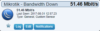

Plugin for Mikrotik RouterOS
* Bandwidth usage monitor for selected interface (by interval requests)
* Manage interface status (realtime)
Can be found here: https://github.com/mrin/domoticz-routeros-plugin
Provides sub devices:
- Bandwidth UP
- Bandwidth Down
- Interface Status

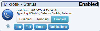

Plugin update 0.1.0
Whats new:
* Manage interface status (status and manage in realtime)
* new core lib for communication with mikrotik for work in non-blocking mode (uses native domoticz framework connection)
