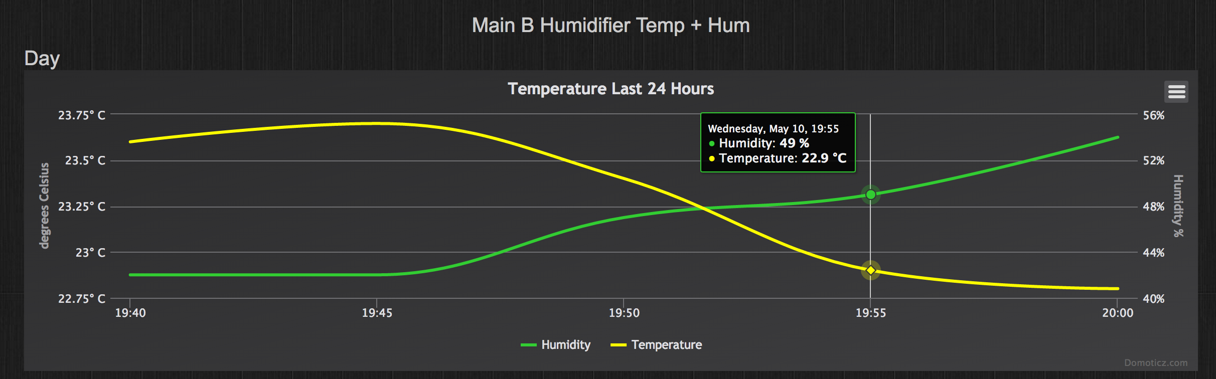

Screenshots:
Screen Shot 2017-05-10 at 7.57.53 pm.png (92.43 KiB) Viewed 9733 times
Screen Shot 2017-05-10 at 7.59.07 pm.png (92.16 KiB) Viewed 9733 times
Screen Shot 2017-05-10 at 8.03.13 pm.png (368.6 KiB) Viewed 9728 times
