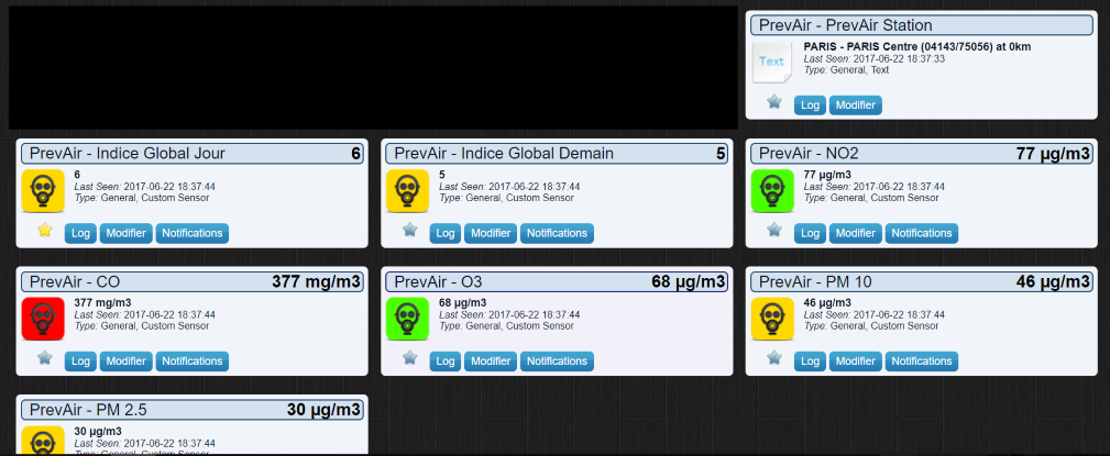

Another plugin (after BatteryLevel) I wrote using the excellent python plugin framework (again many thanks to its active developers), again not to drive a specific hardware but rather to conveniently automate many things that before needed to be done manually (device creation) and with custom scripting...
This plugin reads air quality data from the French PrevAir air quality network of stations across the country and exposes the air quality data from the nearest station (based on the location data of domoticz) or a specific station (if its code is provided in the plugin setup).
The devices exposed by the plugin in domoticz are:
- overall air quality index for today
- overall air quality index for tomorrow
- Detailed level for up to 6 pollutants (SO2, NO2, CO, O3, PM 10 and PM 2.5), depending on the selected station.
You can select the polling cycles for the data on the hardware page (between 1 hour and 24 hours... I recommend 1 hour as it also helps preventing the sensor devices from turning red with the default domoticz setup).
In addition, the device icons will have a different color (green, orange, red) depending on the level of the index or pollutant level (the scale might need some tweaking, bear with me on this for now)
A sample screen capture to illustrate:
The code is on GitHub at https://github.com/999LV/PrevAir. I have yet to write an installation/instructions document, but I am looking for testers feedback for possible bugs or improvement suggestions, so below some basic installation instructions (on a Raspberry... you need to tailor depending on your platform/setup):
