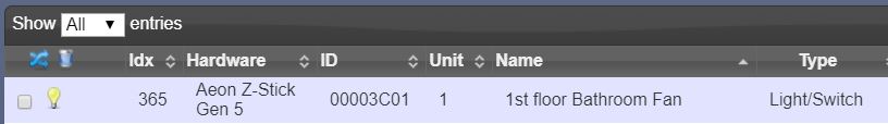

2017-08-08 15:13:00.365 Error: dzVents: Error: There is no device with that name or id: 365
Is this ID?
And can a friendly sole tell me where I go wrong?

    	local 1stFloorBathroomFan = domoticz.devices(365)
        if ( 1stFloorBathroomFan.lastUpdate.minutesAgo > 3 and 1stFloorBathroomFan.state == 'On' ) then
        	1stFloorBathroomFan.switchOff()
