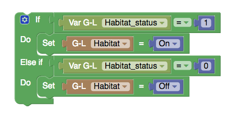

I have been trying to create a simple script to check the last status so it can revert back with a user variable, something like this:
Habitat_status (integer) = 0 <- this is what I call the lamp and 0 = off
Then whenever the switch is triggered via domoticz, it updates the variable to 0 or 1 for off and on. Then I have a time blockly like this:
Screen Shot 2017-08-04 at 20.12.20.png (31.82 KiB) Viewed 754 times
But nothing seems to happen every minute, no trace of it on the log file.
Am I missing anything obvious? Also, has anyone overcome this luck of feedback status from the LIghtwaveRF switches with a clever trick? ;)

I think this will only run when either the switch, or the variable changes state.
If you have a power cut, the switch will physically change state, but domoticz won't know about it.
You could make this a Lua script, get it to run every x mins.
Or, you could create a virtual switch, that would some how know when the system has just come back from a power cut, and would turn on for a few seconds after rebooting. If you include
If this switch = on at the start of your bloky then it will run when this switch is on.
I don't know, but would guess it would be possible to turn a switch on for x seconds after the system has booted?

Thanks, yes I guess I would need to find out when the RPI has just booted for first time to trigger the event. Sounds like it is going to be a bash script this time...
